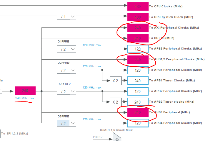

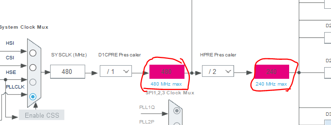

Updated CubeMX as well as H7 libraries, and now see problems with clock configurator, as well as some LL function calls in system clock init has no definition !
STM32H743XI should have 480MHz clock...
And if we generate code, we get problems like this : (H7 V1110)

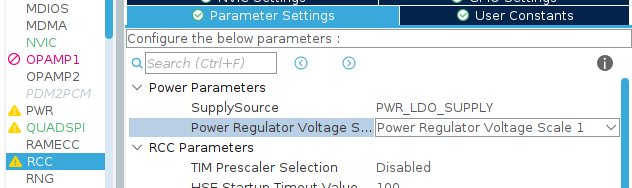

Hello @Linas L​ ,
Solution :
  • To get 480 MHz, go to the RCC parameters and check that the product revision is "V".
  • For some reason the default is "Y".
  • Then set the power regulator voltage scale to 0.

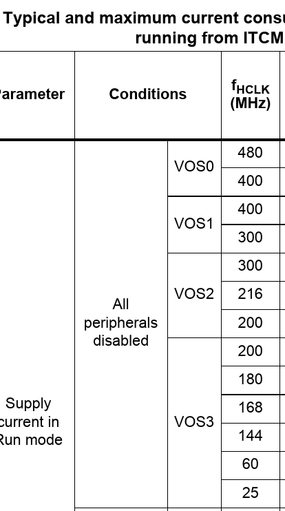

maybe .
but : which core voltage you choose? depending on this setting, max. clock is lower, see ds.
here for H743 (i use.)

no, core voltage settin ! this is vdd supply.
this :

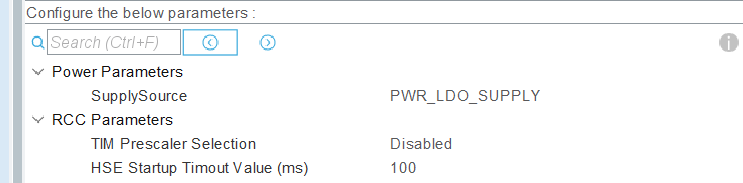

you got the "update surprise" !
maybem they put it from RCC to elsewere , look in PWR, cortex_M7, ..
