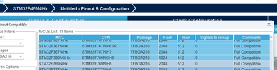

I'm considering migrating from STM32F469NIH6 to STM32F769NIH6. From data sheets it is apparant that these two MCU's have compatible pinout, however the pinout compatibility tool of STM32CUBEMX V6.15.0 doesn't show these MCU's as compatible, why is this?

It shows up for me. Could be due to something you have configured that CubeMX isn't handling properly. The pinout compatibility tool is nowhere near perfect.

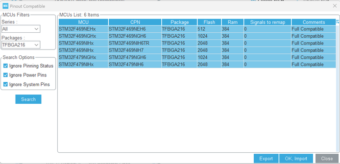

This is the list of pinout compatible devices that I am seeing.

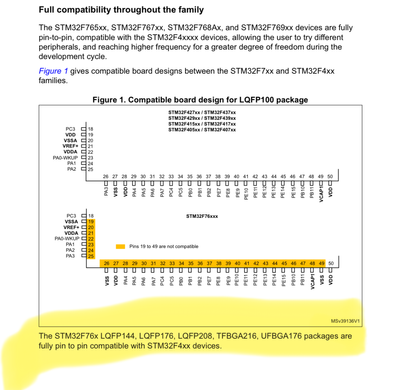

Hi STOne-32, thanks for your reply and pointing me toward AN4660, thank you. AN4660 does indeed shows that STM32F469Nx6 and STM32F769Nx6 are pin compatible, however STM32CUBEMX 'pin compatibility tool' doesn't.
STM32F769NIH is listed as pinout compatible to STM32F469NIH for me:
If you're having trouble, include your IOC file.

Sorry I’m not on my PC to try to reproduce the same behavior on the SYM32CubeMX V6.15.0. But, according to what I’m having here, it seems to be an issue on the STM32CubeMX that should be corrected by ST on the coming versions or it is a problem on your side (including your .ioc file will help). But according to the DS11532 Rev9:
The STM32F76x LQFP144, LQFP176, LQFP208, TFBGA216, UFBGA176 packages are fully pin to pin compatible with STM32F4xx devices.

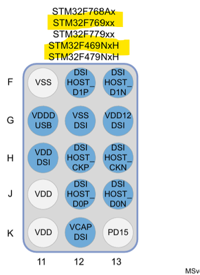

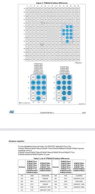

PS: The note I’ve stated previously is not really clear since the STM32F767 TFBGA216 is not compatible pin to pin with the STM32F469 TFBGA216. So, I think the note should be clearer. It can even point to the application note AN4660 for details.
Also, the pin F11 on the TFBGA216 figure (figure 4 of the AN4660) should be VDD and not VSS according to the products datasheets. That should be rectified on the next doc revision.
Finally, the title of the Figure 20 of DS11532 should be changed to avoid any confusion between figure 20 and figure 21.
