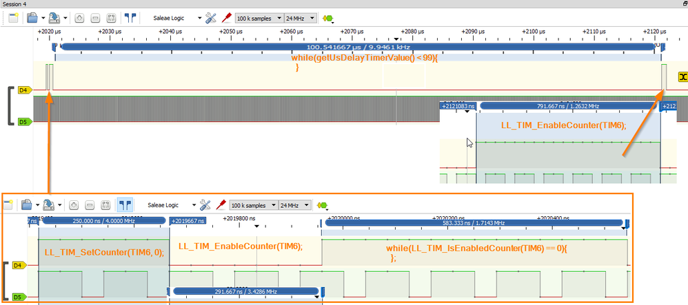

I am having a problem with a timer. I use CubeMX LL drivers, with basic time-base timer configuration.
STM32L100RCT6, TIM6 and TIM7. Core Clock = 32MHz, PCLK1 (TIM6 and TIM7) = 32MHz
Prescaller = 31, which should set timer to tick at 1us. ARR value is set to max, 65535, interrupts are disabled.
Although my timer does tick at 1us, starting and stopping timer adds another few microsecond, which is unacceptable for my application. I added GPIO writes (directly using registers) and check timings with logic analyzer.
Here is the pseudo-code of my test:
// start timer
<GPIO HIGH>
LL_TIM_SetCounter(TIM6, 0);
<GPIO LOW>
LL_TIM_EnableCounter(TIM6);
<GPIO HIGH>
while(LL_TIM_IsEnabledCounter(TIM6) == 0) {};
<GPIO LOW>
// poll timer until value match
while(getUsDelayTimerValue() < 99) {};
<GPIO HIGH>
// stop timer
LL_TIM_DisableCounter(TIM6);
<GPIO LOW>
I assume that any of LL_TIM_x call would be in a range of a few nanoseconds, or at least far below us range, since they mostly resolve into single register writes. The problem is, that in reality, this calls take way more time than they should:
// start timer
LL_TIM_SetCounter(TIM6, 0); -> 250 ns
LL_TIM_EnableCounter(TIM6); -> 291.67 ns
while(LL_TIM_IsEnabledCounter(TIM6) == 0){}; -> 583.33 ns
while(getUsDelayTimerValue() < 99){} -> 100.542 us
// stop timer
LL_TIM_DisableCounter(TIM6); -> 791.67 ns
... which altogether takes: 102.458 us, instead of 100 us as expected.
What am I doing wrong or is there a thing I missed?

These timing seem realistic to me, except the last one with 791 ns.
Consider a sequence of flipping a bit in a control register, and setting the PA6 pin high
TIM6->CR1 |= TIM_CR1_CEN;
GPIOA->BSRR = 1<<6;
Assuming that both peripherals were accessed recently, so their addresses are already held in registers (e.g. r2=TIM6, r3=GPIOA), this would translate to 5 machine code instructions (if optimizations are turned on)
ldr r0, [r2]
orr r0, #1
str r0, [r2]
mov r0, #64
str r0, [r3,#0x18]
loads and stores can take 2 cycles, mov and orr each take 1 cycle, flash latency could stall it a bit too, so 9 cycles seem like a worst case scenario but still plausible. If you'd drop the GPIO stuff, you can excpect almost the half of the overhead to go away.
The last operation taking 791 ns is puzzling, perhaps you can take a look at the disassembly.
You might be able to shave a few cycles off here and there. First of all, use neither HAL nor LL especially when there are tight timing requirements. Note that in the above example, all other bits of CR1 are 0, so writing
TIM6->CR1 = TIM_CR1_CEN;
instead of what LL_TIM_EnableCounter() does makes the time-consuming load from a peripheral register unnecessary, saving 2 or maybe 3 cycles due to pipelining. Using the HAL_ or LL_ functions makes spotting these kinds of unnecessary operations harder. (Is there any possible benefit of using LL?) Check every operation in the reference manual to see whether it's necessary at all. There is no need to check that the counter is enabled after enabling it, so here goes another 500 ns of overhead. You don't even have to start and stop the timer every time, just leave it running, and reset the counter whenever the start of an interval has to be marked.
It should be possible to have an overhead of about 400-600 ns, but I don't think it would go below that. If that's still unacceptable, consider instead what do you need the delay for in the first place. Can perhaps a timer do the task on its own, or trigger a DMA transfer or two to do the job?

Both of you are right: this is not the right approach and what I reported here is actually only a test scenario, because some timings were strange to me. I did as berendi suggested, I have a free running timer and just check current values. I just wan't to clarify this issue.
Hovever, I checked dissassembly code as you suggested and I counted roughly 40 + n*4 instructions, which, at 32MHz adds 1.4us (without while loop). I imagine some instructions are not single cycle and I didn't bother with counting branching... So I guess it is actually as expected.
So, lesson learned: even a single GPIO write to register can take a hundred ns (register write: 3 instructions, @ 32MHz -> 93.75 ns).
Thank you.
