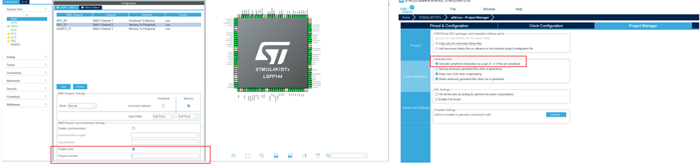

Hello @Johannes​,
First let me thank you for your feedback and your valuable inputs.
Backing to your project, you're using "Enable event" for the "SPI1_TX" DMA request as well as the "Generate peripheral initialization as a pair of .c/.h files per peripheral" option:
When using "Enable event" for the DMA Requests when "Generate peripheral initialization as a pair of .c/.h files per peripheral" option is enabled, STM32CubeMX will generate code with this exception.
This misbehavior is reported internally to be reviewed. I'll surely keep you posted with the updates.
Thus, what I can propose in this case is whether to not to use the "Enable event" or uncheck "Generate peripheral initialization as a pair of .c/.h files per peripheral" option, normally your project will be correctly generated.
