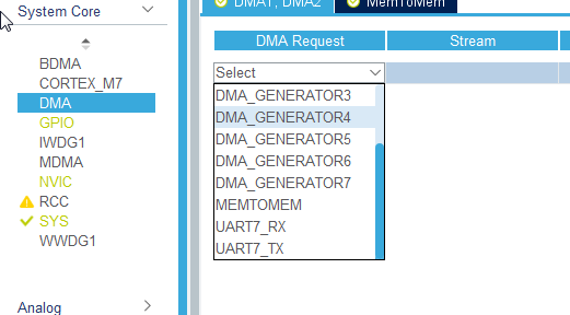

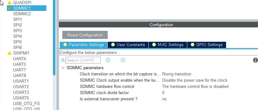

Hello!
I have last version of CubeMX
I try to add DMA to SDMMC1
but I can't see "DMA" option sheet. How can I add DMA?

And I can't see "SDMMC1" in listbox in DMA option page
‎2020-09-06 12:00 PM
Important!
This error is only for STF32H743 chip
For example, F746 chip - I can add DMA for SDMMC1 without any problem
‎2020-09-29 3:56 AM
Hello @EEuge​ ,
It's not an issue, H7 using an Internal DMA (IDMA) contrary to F7, you can refer to RM for more details.
