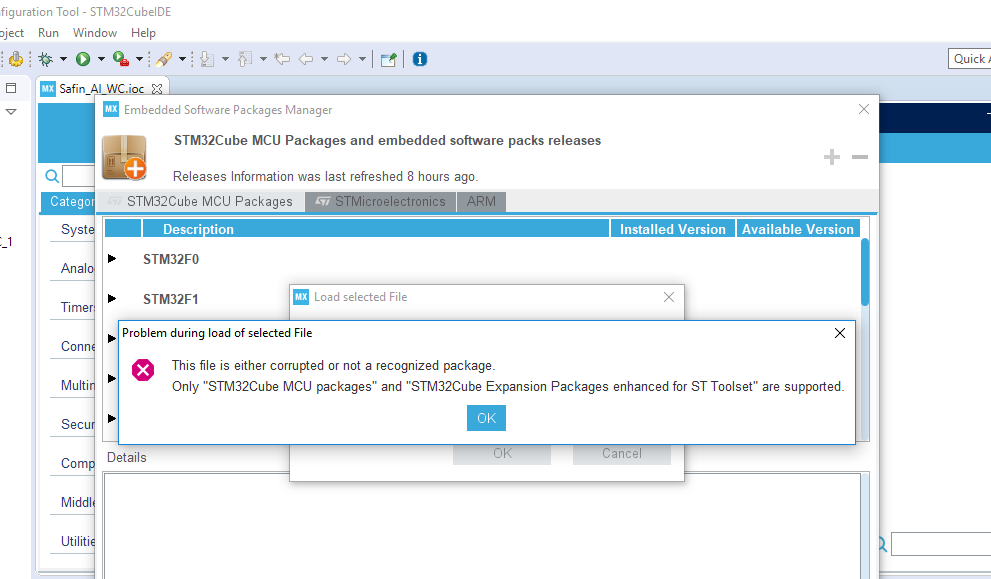

I downloaded the some expansion packages from following link:
https://www.st.com/en/embedded-software/stm32cube-expansion-packages.html#products
and tried to install using STM32CubeMX but i get error... screenshot attached....

Hello @SBS.1​

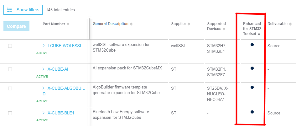

Following the link you provided:

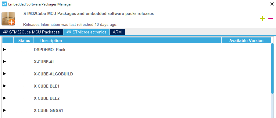

Only the expansion package tagged as "Enhanced for STM32 Toolset" can be open with STM32CubeMX.
Those ones can also be found and downloaded from STM32CubeMX.
The others, as mentioned by @Mikhail Z​ are just standard zipped archives.
