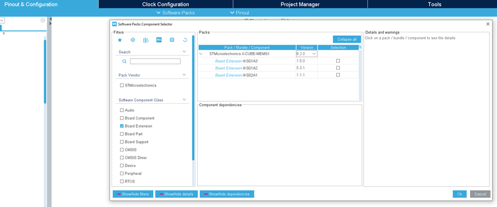

Hi guys! I'm using X-NUCLEO-IKS01A1 for academic work and I need to use AI with SMT32CubeMX too, but IKS01A1 is not supported any more in SMT32CubeMX. What can I do to add that module to a new project? Can I download a library or change something?

Hello JCuer.2,
Welcome to our Community :)
Since X-NUCLEO-IKS01A1 product is no more recommended for new design, it is not supported by SMT32CubeMX.
Otherwise, X-CUBE-MEMS1 expansion software package comes with a sample implementation of the drivers running on the X-NUCLEO-IKS01A2/X-NUCLEO-IKS01A3/X-NUCLEO-IKS02A1 expansion boards connected to a featured STM32 Nucleo development board.
This package is compatible with STM32CubeMX,  can be downloaded from and installed directly into STM32CubeMX.
0693W000006FrgYQAS.pngI hope this will help you to find a solution for your project.
Khouloud.

Hi @Khouloud OTHMAN​ , thank you for your answer.
I have seeing that inside X-CUBE-MEMS1 there is an option "STM32Cube_Custom_BSP_Drivers". It would be a better approach than using for example X-NUCLEO-IKS01A2? Where can I find documentation about making "STM32Cube_Custom_BSP_Drivers"?
