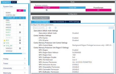

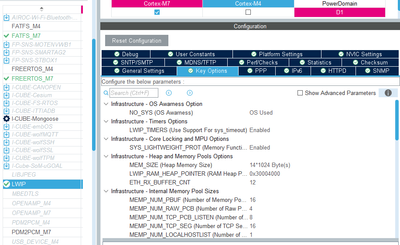

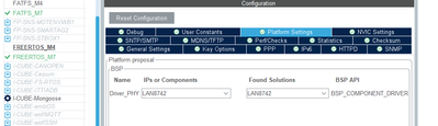

I set MX in this way:

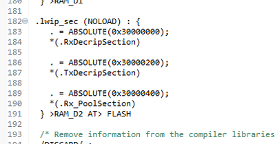

The linker script

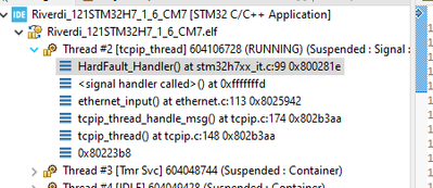

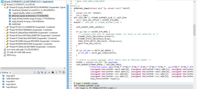

I compiled and I connect ethernet cable and it seems work poperly because if I ping I obtain right answer,
but! sometimes processor goes to HardFault

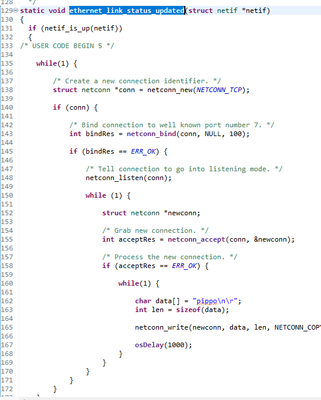

I've writed simple TCP server that accept connection on port 100 and send "Hello" every second.
When I try to connect with TERA TERM it goes immediately on HardFault.
Here the code of ethernet_input
Can someone Help me ?
Thankyou in advance

Cuold be insufficient stack size.
Look at the ethhdr pointer and ensure it's valid. If it's not, set up a hardware watchpoint to see where and when it's changed.

Yes @TDK I watch the address: is 0x28000045
and ethhdr->type is 0x24001b64
how to increase stack size for tcpip_thread ? maybe TCPIP_THREAD_STACKSIZE ?
MauFanGilaMedical
April 30, 2025
it seems msg->msg.inp.p point to invalid address: 0x28 ...
No RAM @ 0x28...

Here's how to set a watchpoint:
https://community.st.com/t5/stm32cubeide-mcus/how-to-add-the-watchpoint/m-p/310217/highlight/true#M16720
You want to watch for the pointer to change, so add &ethhdr as the expression.

Watchpoint is disabled maybe ethhdr is a local variable

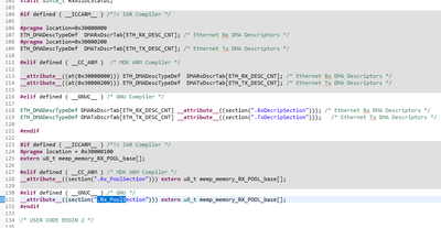

Can you check that the types on line 113 match, also check that ethhdr->type is properly initialized ?

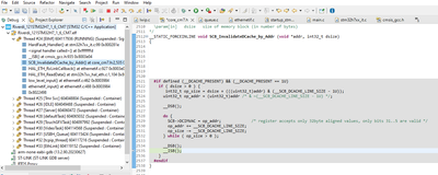

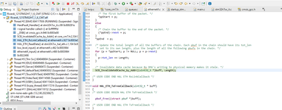

When I go to HardFault I shot the stack and see if one thread stack overlap the next but I don't see this situation
MauFanGilaMedical
May 5, 2025

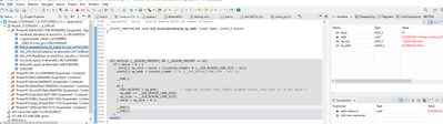

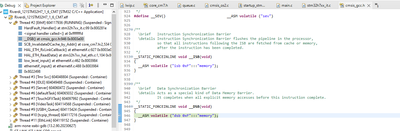

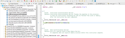

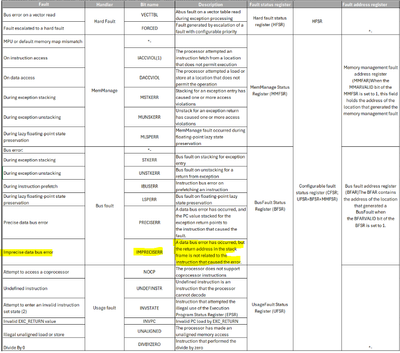

Today it goes to HardFault from __ISB or __DSB:
Stack for __DSB
And stack for __ISB

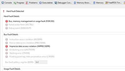

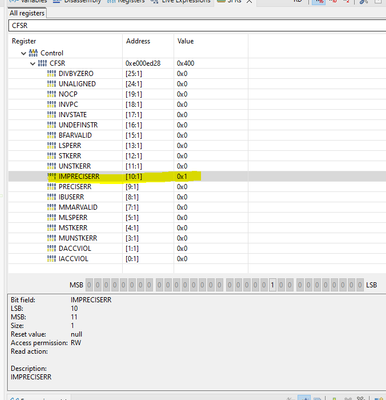

If could be helpful the CFRS is IMPRECISERR

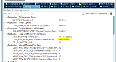

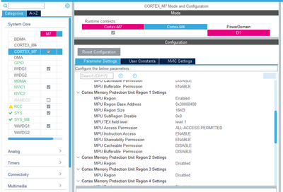

I observe that memp_memory_RX_POOL_base is at 0x30000400 and its size is 18,38KB, so memp_memory_RX_POOL_base spans in 0x30000400..30004BCC.
Starting from this I set LWIP_RAM_HEAP_POINTER to 0x30005000 because I suspect that memp_memory_RX_POOL_base overlaps LWIP_RAM_HEAP_POINTER.

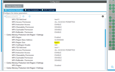

Then I go to MPU and increase MPU Region 1 Size from 16K to 64K because it started from 0x30000400 and its size is 0x30005000-0x30000400+14KB

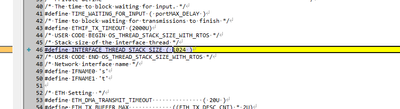

Subsequently I increase INTERFACE_THREAD_STACK_SIZE from 350 to 1KB ..
And I increase that stack of Server thread from 1KB to 10KB (even if I want to undersand how to reduce it to a minimum necessary size)
With this change the Server works without MCU crash... I observed one/two crashes and I'm still investigating.
I notice that when I send packets from PC to MCU sometimes MCU crashes
