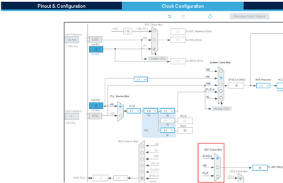

Despite enabling ADC, the ADC clock option is greyed out for MCU STM32G0B1KBUx. I'm using version 6.16.1

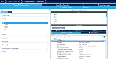

Hello @G5658 ,
Under ADC Settings, you need to set the clock prescaler to: Asynchronous clock mode.
Thanks.

Hello @G5658 ,
Thanks.
