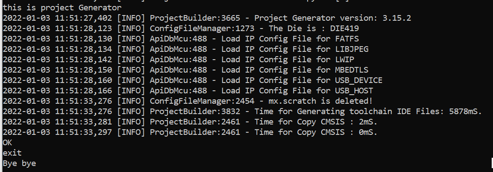

  • After downloading your .ioc file, I've created a script file (script.txt) containing the following commands:
config load <ioc_Location>\mainBoard.ioc
project generate
exit
  • Via command line window, I ran the command:
C:\Program Files\STMicroelectronics\STM32Cube\STM32CubeMX-6.4.0>jre\bin\java -jar STM32CubeMX.exe -q "<script_file_Location>\script.txt"
The project is generated correctly without any errors:
0693W00000HqOF7QAN.pngDid you do it differently or did I miss something ?
Thank you in advance.
Khouloud.

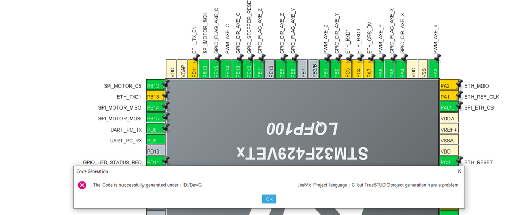

0693W00000HqPgYQAV.pngI've just get the same result using gui.

Oddly, I have always no problem with code generation using command window and also CubeMX GUI; the project is generated successfully without any displayed errors.
Noting that I'm using STM32CubeIDE as a toolchain because of the limited support of TrueSTUDIO.
You'll find attached the generated project from my side.
