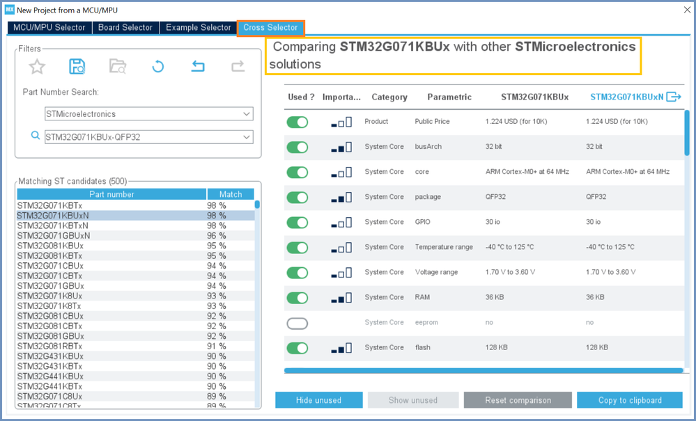

Difference between STM32G071KBTx and STM32G071KBTxN?
Fèlix
Have you ever seen the "N" suffix at the part number? Is the first time I see it. It seems to be some pinout differences, but... it implies any more differences?

In the datasheet: " other = 3-character ID incl. custom Flash code and packing information; x = N for PD product version"

Hello @F�lix​
Thanks for your question,
As mentioned By @Uwe Bonnes​, STM32G071KBT6xyy with xyy = N option means the PD product version.
I would take this opportunity to present you the Cross Selector in CubeMX, it's an easy way to compare two or more Part Numbers:
Hope my answer helped you, when your question is answered, please close this topic by selecting the reply which helped you the most as best, it will help other find that answer faster :).
