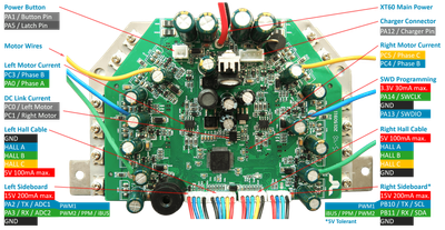

i have a hoverboard motor controller in which there is STM32F103RCT6.
i have hacked the firmware but it was not working due to some reason; some MOSFET got burned.
i tried to check communication with Arduino.

when I flash it, my STM is not being detected by ST-Link. I am trying to check whether the issue is with the STM or the firmware. I also flashed it into another board, but the same issue happened, so I guess the problem is in the firmware.
the power is good; I checked between all VDD and VSS and it is good (3.27V).
there is BOOT0, BOOT1, and NRST.
BOOT0 and BOOT1 are low and NRST is high.
when I short BOOT0 with VDD, the ST-Link turns off.
I am completely lost.
the screen shot is after and before firmware

l am using this board (hoverboard contoller) it was working before the problem is i flashed the firmware which by some reason made the stm not loading by stlink
how can i completely reset the chip so the stlink debugger can work i have now working code
attached the schematic i found online
