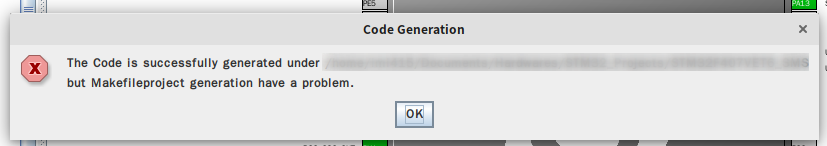

After updating to CubeMX 4.26.0, Makefile projects cannot be updated due to the following errors:
2018-06-08 00:35:55,360 [INFO] ToolchainGenerator:120 - stack trace : java.lang.UnsupportedOperationException: Not supported yet.
at generators.MakefileGenerator.updateHeapAndStack(MakefileGenerator.java:315)
at generators.Generator.generateLinkerFile(Generator.java:715)
at generators.Generator.copyLinkerFile(Generator.java:407)
at convertor.Convertor.generateMakefile(Convertor.java:1436)
at convertor.Convertor.generate(Convertor.java:608)
at convertor.Convertor.convert(Convertor.java:515)
at convertor.Convertor.updateProject(Convertor.java:384)
at com.st.microxplorer.plugins.projectmanager.model.ToolchainGenerator.update(ToolchainGenerator.java:114)
at com.st.microxplorer.plugins.projectmanager.engine.ProjectBuilder.createToolChainFolders(ProjectBuilder.java:1780)
at com.st.microxplorer.plugins.projectmanager.engine.ProjectBuilder.createProject(ProjectBuilder.java:574)
at com.st.microxplorer.plugins.projectmanager.engine.GenerateProjectThread.run(GenerateProjectThread.java:41)

Hi All,
There is an issue with regeneration of makefile project with the 4.26.0.
This will be fixed in the 4.26.1 which will be on the web soon

Today, I tried the 4.26.1.
but, this problem wasn't solved...
VPand
I'm facing this issue with KeilProject and TrueStudioProjects also. Version 4.26.1. Problem is still not solved.
imi415
However, after recent update to 4.26.1, project generator is completely unusable..
Code generation succeed while project generation always failing.
Updated system Java to 10 solved everything.
Makefile re-generation still fails.
Everything unstable now...
