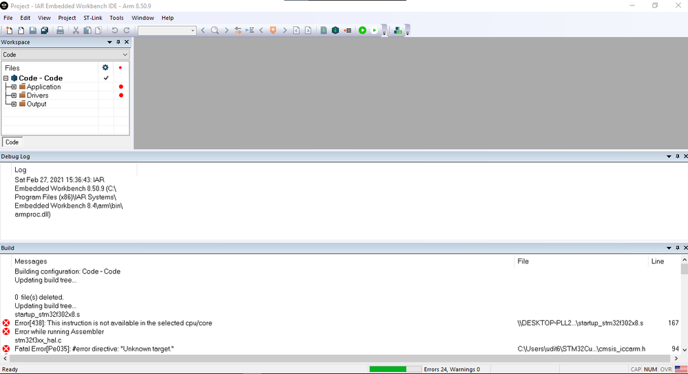

I have been having trouble getting CubeMX to generate a EWARM project that will compile in IAR Workbench. I looked at this thread so far, but I do not think it will fix my issue since I am currently used IAR 8.50.9. I do not know what is causing the error and do not know what additional debugging information I should post. If any one knows what could be causing this, please let me know.

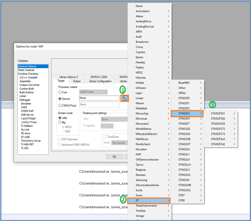

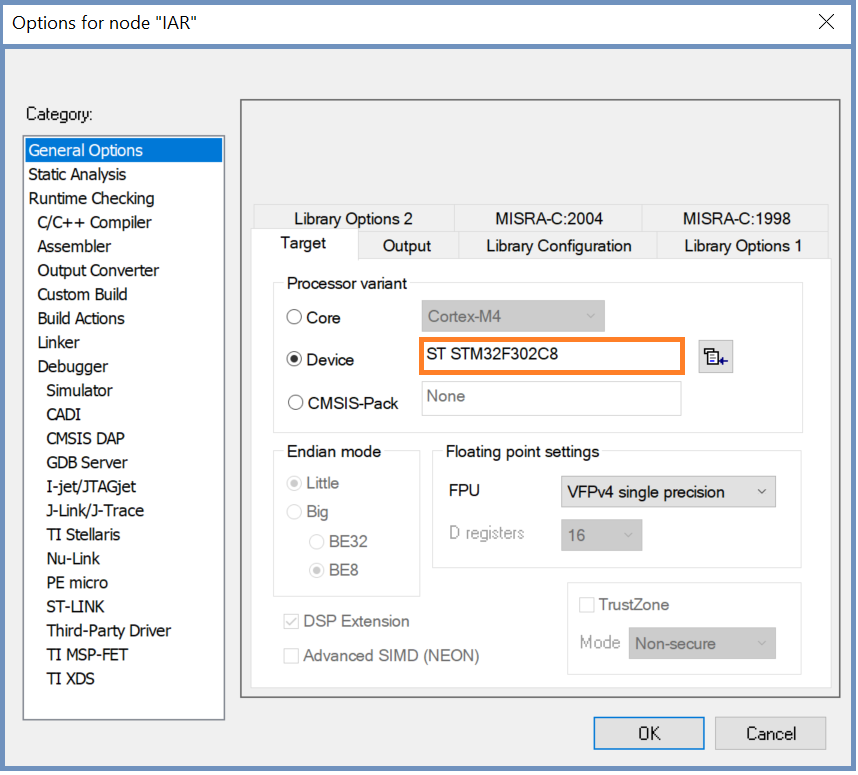

In fact, you need first to download the stm32F3 patch for IAR if you don't have it, then right click on the name of your project in the IAR workbench IDE, click on option and finally add your device as mentioned in the images below ( the device is None in your case and therefore a similar issue will appear) .

Yes, this solved my problem! Thank you for the help!
