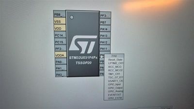

Inside Cube config, i do not get the other internal connected pins on pin 14, only PA8... in older versions it was available.
The chip is STM32U031F8...
What do i do wrong.. i need to use the uart_tx function on pin 14...
Thank you

Hello @KJeps.3
I have raised this issue internally to the dedicated team for fix, (Ticket 227473 This is an internal tracking number and is not accessible or usable by customers.)
As a temporary workaround, I suggest that you copy the generated code of USART from the old project or to add this code manually to stm32u0xx_hal_msp.c :

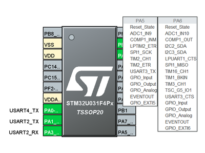

I just created the project in freshly installed cubemx, and pushed the pin... the 2 other IO pin connections do not pop up...
I have now tried to enable USART, seems not to change anything...
For pin PA5 it seems to work ok to show more IO:

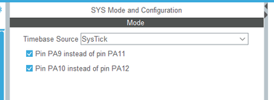

Hello @KJeps.3
To use the alternate functions of PA9 and PA10, you can use the remapping option under SYS as follows:
As it is possible to use PA9 instead of PA11 and PA10 instead of PA12. (you can use USART1_TX with pin15)

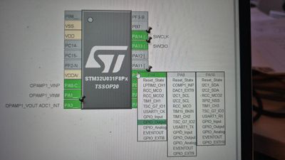

I have to use pin 14 as the HW is already made...
/Kasper
