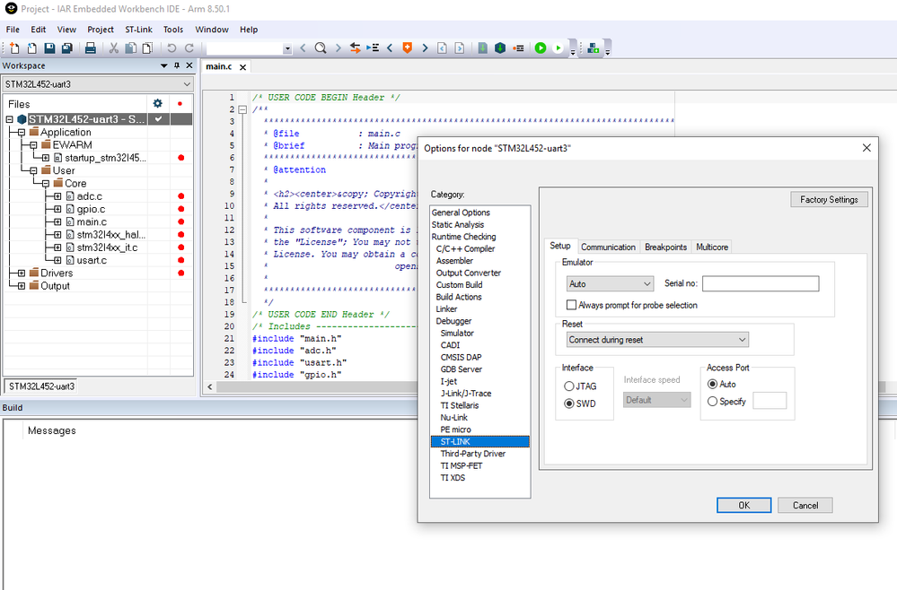

Can not find ST-LINK I am using STM32CubeMX to generate IAR project code, but ST-LINK device doesn't work.

Hello STai.2,
I can't reproduce the issue. Generating code from the attached .ioc file using EWARM IDE, ST-Link can be successfully configured:

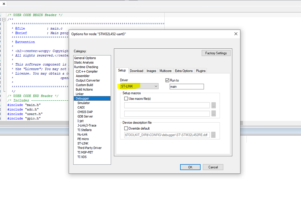

Under the Debugger section, please make sure that "ST-LINK" is selected as the driver:
Otherwise check "IAR Embedded Workbench for Arm" installation: You can find IAR's drivers for ST-Link for EWARM (Windows) in "C:\Program Files (x86)\IAR Systems\Embedded Workbench 8.5\arm\drivers\ST-Link" . Alternatively, you can change your installation of "IAR Embedded Workbench for Arm", selecting "Modify", and checking the option box for "ST-LINK" during the modify process.
