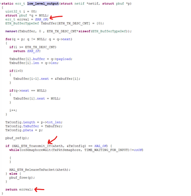

[BUG] STM32 lwIP ethernetif.c incorrect error evaluation in low_level_output()
Jak
When HAL_ETH_Transmit_IT() returns an error the errval variable is not changed from ERR_OK to reflect that in the else section.
1 REPLY 1
Semer CHERNI
Hello @Jak
Could you provide more details about the project configuration:
  • The CubeMX version used
  • The used MCU
  • If possible the ioc file to be able to reproduce the issue.
KR,
Semer.
