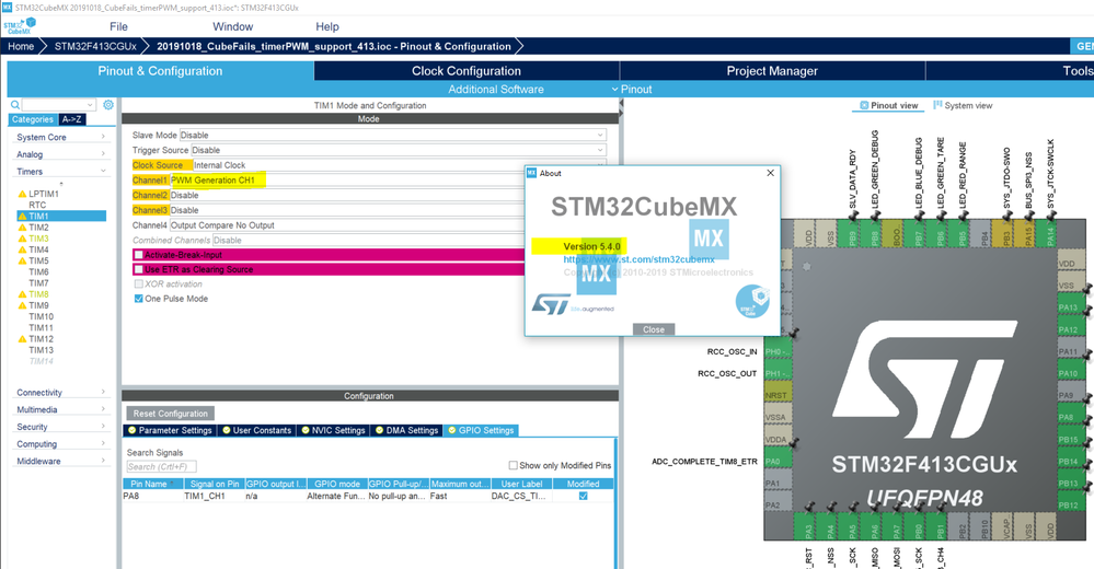

RubeMX shows only 5 of 7 possible timer channel modes. It fails to show PWM modes. Attached IOC shows problem (try to set PWM mode for timer 1 or timer 3).
STM32CubeIDE Version: 1.1.0
Build: 4551_20191014-1140 (UTC)
OS: Windows 10, v.10.0, x86_64 / win32
Java version: 1.8.0_202
Please confirm you have reproduced this and filed a ticket...
Thanks, Best Regards, Dave

Khouloud Zemmeli (ST Employee) - As I wrote above, I am trying to use STM32CubeIDE Version: 1.1.0. Are you saying this bug is fixed in the stand-alone CubeMX, but not the CubeMX included in ST's IDE??
​Strating your project from CubeMX (5.4.0) or CubeIDE (1.1.0) , Same result , the PWM mode is supported .
Best Regrads,
Khouloud.
@Khouloud ZEMMELI​ - This bug is still not fixed. I just tried again in CubeIDE after updating all MX definitions.
The PWM options are still missing.
The generated report says
STM32CubeMX 	5.4.0
Date	10/25/2019
MCU	STM32F413CGUx
