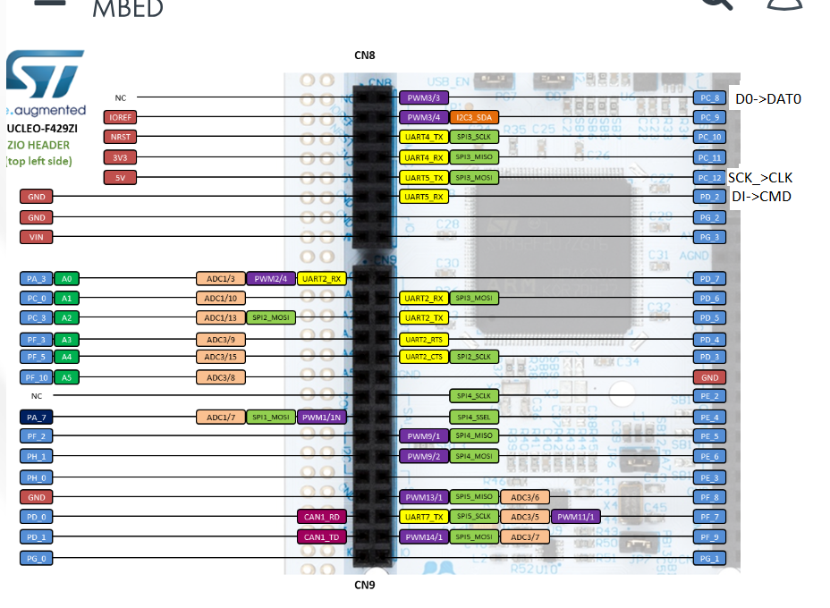

I'm trying to read and write to a microSD card using this reader from sparkfun https://www.sparkfun.com/products/12941 and a nucleo board with a STM32F429ZIT6U MCU via SDIO interface. I created the project through CubeMX V 4.21 (I used the most current version 5.2 at first and ran into issues then saw some forums that said 4.21 was more stable). SDIO and FatFs middle ware were enabled in CubeMx and well as LED1 and LED2 (PB0 and PB7). I got the program from and followed these series of videos for the main.c code https://www.youtube.com/watch?v=Y5UMTGQDmog and https://www.youtube.com/watch?v=0NbBem8U80Y&t=218s. Here's a snip of main.c

When I run my code in True studio f_mount doesn't work. More specifically res = find_volume(&fs, &path, 0) in ff.c line 2511 doesn't return FR_OK. I've attached the VCC and ground wires to 3.3V and ground on my board and DO, SCK,and DI to PC_8, PC_12, and PD_2 respectively. 0690X000008AvtzQAC.pngThe micro SD card is formatted to FAT32. No files are created on my MicroSD card and I've no idea what I'm doing wrong.

Used these same adapters wired in 4-bit mode on NUCLEO-144 boards.
They lack pull-up resistors, so going to be more dependent on pin configurations.
Make sure library code is not trying to switch to 4-bit mode.

>>I'm not sure what you mean by its going to be more dependent on pin configuration.
Well for starters whether the code selects internal pull-ups on the pins, and the drive speed (slew rate) settings of the pins. Likely buried in the CubeMX MSP code.
