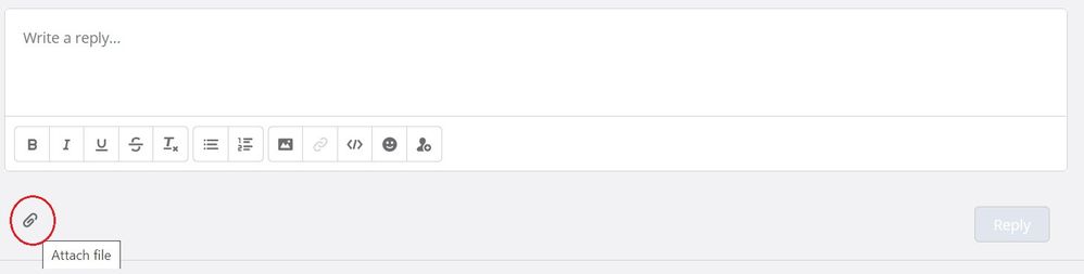

Hi @AFerr.1​ ,
Thanks for your reply, but you may not correctly attach the files. Please make sure you're using the right tool:
