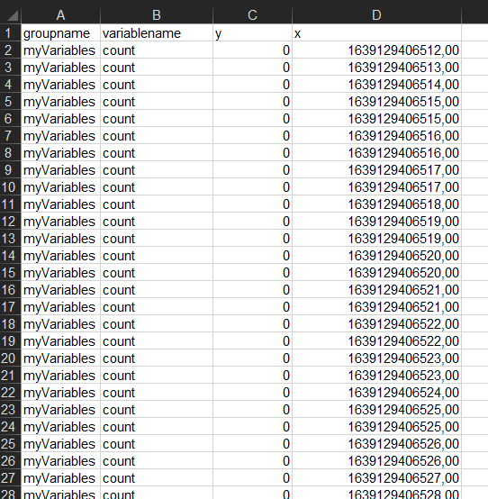

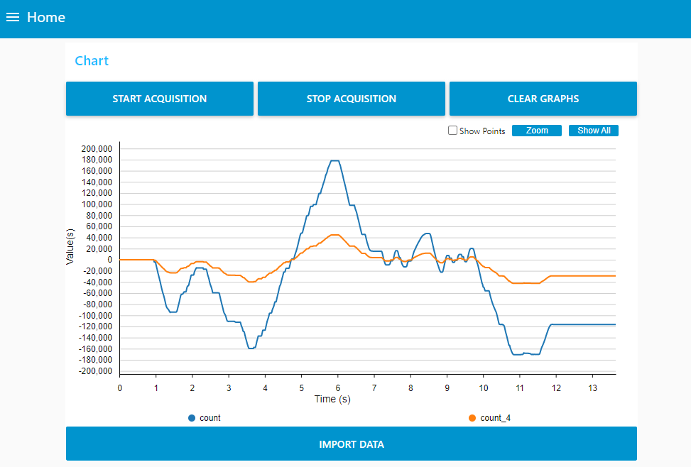

I want to save the data of a variable with stm32cubemonitor.
I can monitor this variable and save the data in a .csv file.
0693W00000Ho8ztQAB.pngbut the saved data for time are somehow incorrect.
0693W00000Ho9fzQAB.pngIt is started in 1639129406512,00. It should start from 0.
The values of variables are correct.
Could you please help me?
Richard.Chvr
Hello @Nmo.1​ ,
The time data are correct, but the graph template used is considering fist time input as 0.
If you want to match graph and saved data you need to remove first time value to the whole time column.
