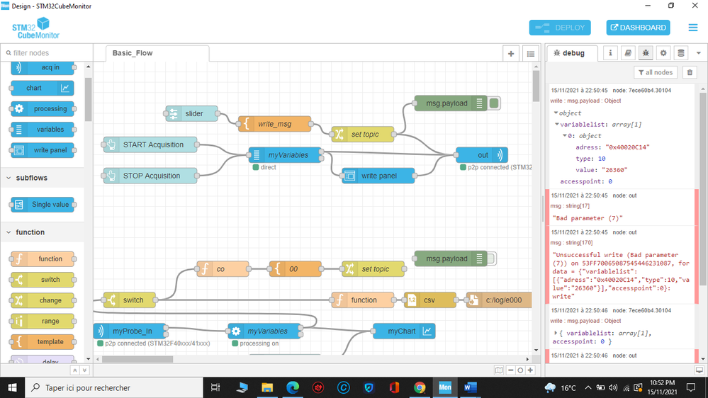

‎2021-11-11 2:10 PM
I follow the instruction and i receive this error:
"Bad parameter (7)"
msg : string[264]
"Unsuccessful write (Bad parameter (7)) on 48FF6E064986484820270787, for data = "{\n \"variablelist\": [\n {\n \"address\": \"0x20000000\",\n \"type\": 3,\n \"value\": \"3678\"\n }\n ],\n \"accesspoint\": 0\n}": write"
Do you know what's wrong with it? I check the address and i type and they are correct.
‎2021-11-15 10:03 AM
Hello
I thing the \n in the log are strange.
Can you compare with the wiki example here : STM32CubeMonitor:How to write a variable from flow - stm32mcu ?
Take care to set the output of "template" node to "parsed JSON".
If not ok, can you insert a debug node after "set topic" node to see what is sent to the node "myProbe_Out" ?
Please let us know the result.

‎2021-11-15 1:54 PM
I do the same work as the link, this is my basic flow .
thank you
