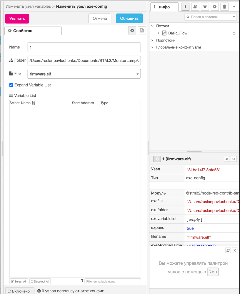

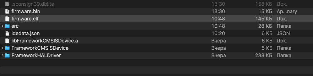

If you add a project folder, the program finds firmware.elf, but does not find variables in this file.
This is a working project, stm32f030 with this firmware is on my desk and works.
For the experiment, I started CubeMonitor under sudo, I thought, maybe the program does not have permissions to access the file, I gave permissions to the file for everyone, but this did not solve the problem.
Does this problem have a solution?0693W00000JQBBIQA5.png0693W00000JQB6cQAH.png

I figured it out and it was in the build_flags = -ggdb parameter. But now there is another problem. All data on the graph is zero. I made a test variable ++, but it is also 0 all the time.
