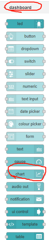

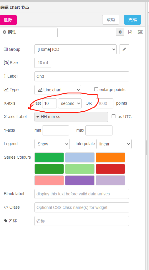

I want to graph a data waveform that lasts 10 seconds without recording every 10s' data in chart.

0693W00000WHVuHQAX.png0693W00000WHVulQAH.pngI just want to display 10s data, but the chart records every 10s data ,,the chart display many 10 second data.

Looks like you're using the node red default chart, not the ST specific one. May be you can find a node complying your need in the available nodes on the web. STM32Cubemonitor is only providing a limited list of nodes.
