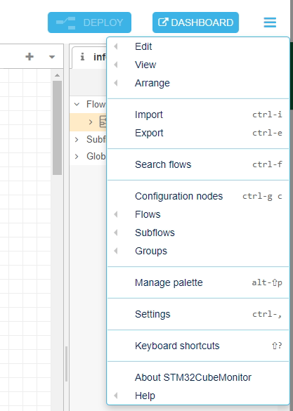

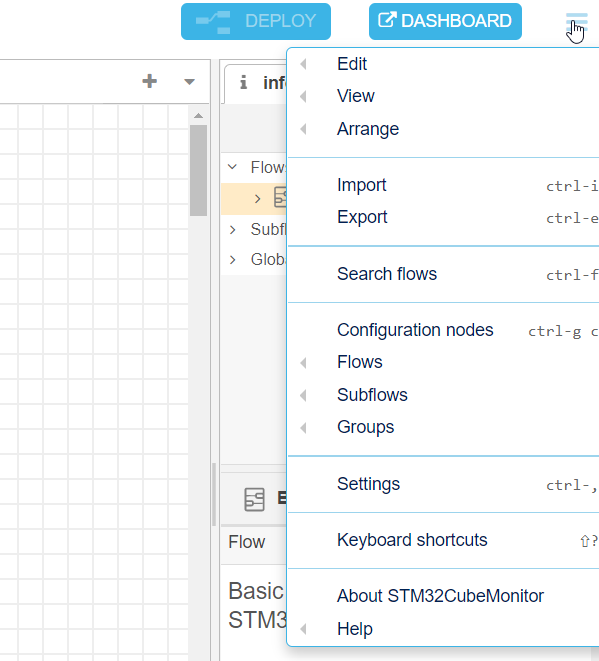

I have STM32CubeMonitor v1.4.0 installed on my home computer and work computer.
On my home computer, there is an option called "Manage Palette" which allows me to add additional nodes from nodered online resources
On my work coputer, there is no such option.
As far as I can tell, I have the same version of STM32CubeMonitor installed on both machines.
Here are screenshots showing the main dropdown for each computer:

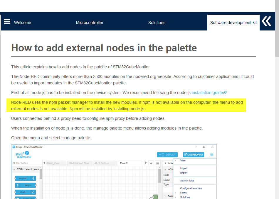

Never, mind, just saw this on the guide page
‎2022-11-01 11:52 AM
