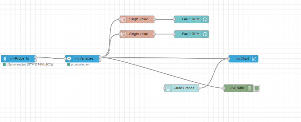

I think it is a basic question but I can't find a solution.
I read 4 variables, 2 fan RPM and 2 temperatures.
I route the two RPM to a gauge, and I would like the temperature to a char (only the temperature). Because the scale is very different.
Gauge is working, I can filter.
I don't know what to insert between "processing" and "chart" to remove the RPM variables to the chart:
Thank you,
Pierre

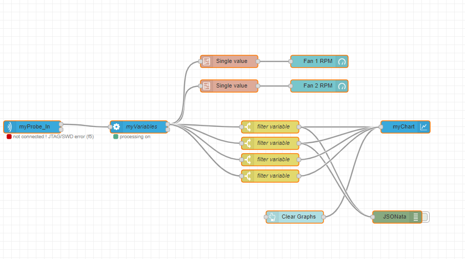

Hello Pierre
There are 2 options :
  • Create 2 groups of variables, one for the gauge and one for the chart. You will have 2 processing nodes, and one can be connected to the gauge, the other to the chart.
  • Add some filtering nodes on the output of myVariables processing node. The "switch" node in the palette will do the job, filter on the property msg.payload.variablename and set == myVariable
The switch node configuration : (Copy this code, go to menu "import" and paste the code. then replace "myVariable" by your variable name)

Hi Stéphane,
Thank you for the answer.
For the first solution I had tried before but without success. I will try again.
For the second solution It works. But it seems that I need to add a filter for each variable. A single filter with multiple variables does not work.
