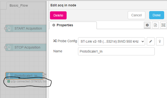

  • Nucleo-L152RE with ST-Link board still attached and power from USB
  • STM32CubeIDE configured as picture.  Freq at 1000K to match slow speed set in the Monitor
  • Also Debug Config has ST-Link Shared
STMCubeMonitor has the probe set up like this:
... it's connected and everything.
However, when I launch the debugger from CubeIDE, or I launch from CubeProgrammer, the probe immediately goes red with the [not connected ! Device not opened (5)]
In my attempts to fix this myself, I added this to my code:
#define DEBUGGER_ON 1 //REMOVE BEFORE FLIGHT
#define LOW_POWER_DISABLE 1 //REMOVE BEFORE FLIGHT
In my attempts to fix this myself, I also tried flashing my program onto the STM using CubeProgrammer.  I had the same effect.  While the CubeProg was attached my program ran but CubeMon said the Device was not open.  I would close CubeProgrammer and the program would stop but CubeMon finally found my device.
I'm clearly in need of better understanding.  My guess is ST-Link is not sharing very well.  Any suggestions would be greatly, greatly appreciated.

Richard.Chvr
Hello @Skyko
Did you install STLink_server ?

Skyko
Thx for the reply @Richard.Chvr!  Yes, it is installed properly with the latest revision as shown below.Skyko_0-1693587425747.png
Richard.Chvr
HI @Skyko
I finally open my eyes and see your configuration is p2p whilst it should be tcp. You also need to configure STM32CubeMonitor in shared mode:
 https://wiki.st.com/stm32mcu/wiki/STM32CubeMonitor:How_to_configure_shared_mode
