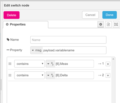

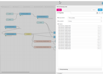

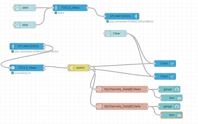

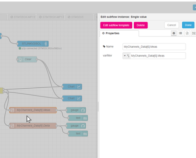

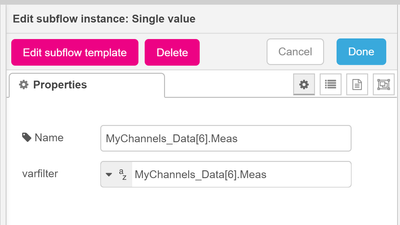

    Datas are:
    Switch is:
    Single Value is:
    Text is:

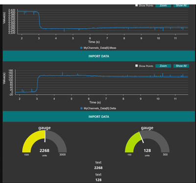

    OlivierR
    September 4, 2023

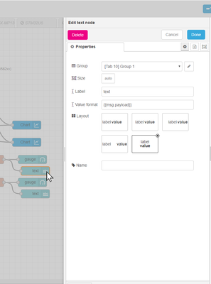

    text and gauge modules can be used:
    regards.

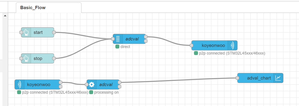

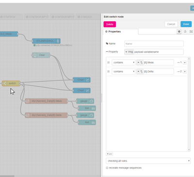

    OlivierR
    OlivierRBest answer
    September 5, 2023
