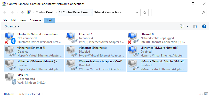

‎2021-01-10 9:33 AM
Just a quick note to help.
I had exactly the same issue and tracked it down to a bug to STM32CubeMonitor. The ST software basically try to communicate with the wrong network interface. Disabling Hyper-V didn't help here, because I also have VMware installed and it causes the same issue.
To fix it, you have to disable all virtual network interface in Control Panel\All Control Panel Items\Network Connections
