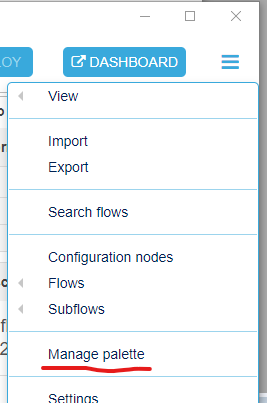

Hello, I wondered if you will add the ability to import/add new nodes to the STM32CubeMonitor system from the Node Red Library (https://flows.nodered.org/)?
After all this is one of the strengths of the Node Red system to enable the use of collabrative built nodes.

Hello Michael
It is possible to add nodes in the palette with the menu "Manage Palette".
You may not see the menu because Node-Red uses npm to install nodes, and the menu "Manage Palette" is not available when npm is not installed on the computer.
In order to add nodes in the palette, you need to install nodejs (with npm). Then the menu will be available, you will have access to Node-RED nodes.

Hi Stephane
Thats excellent news.... many thanks
