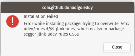

There is a big issue I'm facing. I just installed STM32CubeIDE 1.2.0 but then I get an error when trying to install JLink_Linux_V662_x86_64.deb
I absolutely need those tools because I also do development for other boards with Segger JLink probes.
What is going on? My system is Linux Pop!_OS 18.04 LTS x86_64

To install  JLink_Linux_V662_x86_64.deb, you must first remove segger-jlink-udev-rules with the following command:
sudo dpkg -r --force-depends segger-jlink-udev-rules
This should not be an issue to run CubeIDE as segger-jlink-udev-rules only delivers /etc/udev/rules.d/99-jlink.rules which is also provided by JLink_Linux_V662.

I can successfully install JLink_Linux_V662_x86_64.deb now with the suggested command but then STM32CubeIDE disappears. To install it again I have to uninstall JLink_Linux_V662_x86_64.deb and then I end up as in the beginning.

Well,
Let's take it back from the beginning/
(assuming XXXX is your version of CubeIDE)
1) install CubeIDE debian bundle:
sudo bash st-stm32cubeide_XXXX_amd64.deb_bundle.sh
2) you should get something like this:
dpkg -l "st-st*" "segger*"
Desired=Unknown/Install/Remove/Purge/Hold
| Status=Not/Inst/Conf-files/Unpacked/halF-conf/Half-inst/trig-aWait/Trig-pend
|/ Err?=(none)/Reinst-required (Status,Err: uppercase=bad)
||/ Name             Version       Architecture    Description
ii segger-jlink-udev-rules   6.62        all         segger-jlink-udev-rules
ii st-stlink-server       1.3.0-4       amd64        stlinkserver
ii st-stlink-udev-rules     1.0.2-2       all         st-stlink-udev-rules
ii st-stm32cubeide-XXXX amd64        IDE for STM32
3) Remove udev-rules-only segger package:
4) Now you should have this:
un segger-jlink-udev-rules   <none>       <none>       (no description available)
CubeIDE is still there:
ls /opt/st/stm32cubeide_XXXX/stm32cubeide
artifacts.xml features      icon.xpm notice.html plugins stm32cubeide
configuration headless-build.sh jre    p2      readme  stm32cubeide.ini
5) install Segger JLink:
sudo dpkg -i JLink_Linux_V662a_x86_64.deb
(Reading database ... 239470 files and directories currently installed.)
Preparing to unpack JLink_Linux_V662a_x86_64.deb ...
Removing /opt/SEGGER/JLink ...
/opt/SEGGER/JLink not found (OK)
Unpacking jlink (6.621) ...
Setting up jlink (6.621) ...
6) Check what you have:
dpkg -l "st-st*" "segger*" "jlink*"
ii jlink            6.621        amd64        SEGGER J-Link tools
ls -l /etc/udev/rules.d/99-jlink.rules
-rw-r--r-- 1 root root 20919 janv. 24 16:20 /etc/udev/rules.d/99-jlink.rules
Can you check this on your system?
Best regards.

Awesome!! after following this I finally have both STM32CubeIDE and Segger JLink both working at the same time. I think the secret was to install JLink from the command line. Before, I was executing the same steps but double-clicking the .deb file to install JLink.
