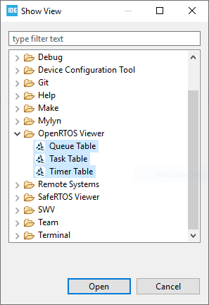

RTOS aware debugging is on the road map but has not been transferred over from TrueSTUDIO yet, other features has gotten priority.
There is J-Link support but it's sometimes filtered in version 1.1.0 (will be fixed in the next release), what target are you trying to debug?
Some perspectives has gotten a different layout and default views but it should be easily customized.
‎2020-01-08 12:40 AM
If you use FrreeRTOS then you can try the state-viewer plugin from this web page:
https://www.highintegritysystems.com/tools/stateviewer/
It provides the Task, Queue and Timer views.
