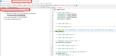

when I copied project and rename it, the debug still debugs the copied source files, not the new one
demir
Senior II

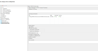

I have created a project by simply performing copy and paste. I copied 002LED_Tasks and pasted onto project explorer, then rename it as 004LED_Periodic_Tasks.
When I debug the 004LED_Periodic_Tasks, debugger debugs the 002LED_Tasks.
Please find attached images.
Could you please point me to the right direction in which I can resolve this problem ?

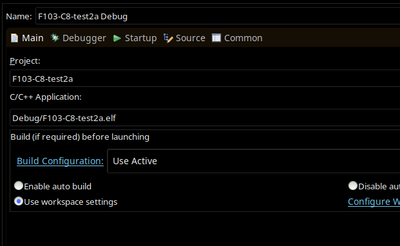

AScha.3

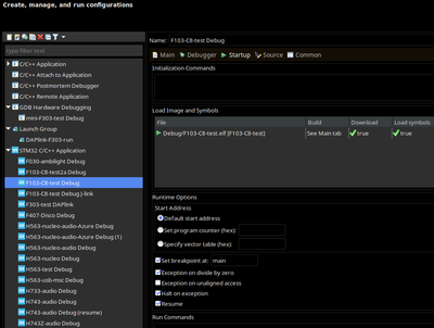

Just look in your debug configuration -> settings, what file is used for debug (and change it...):

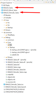

seems like problem is not about that, please see below. What could be the root cause ?

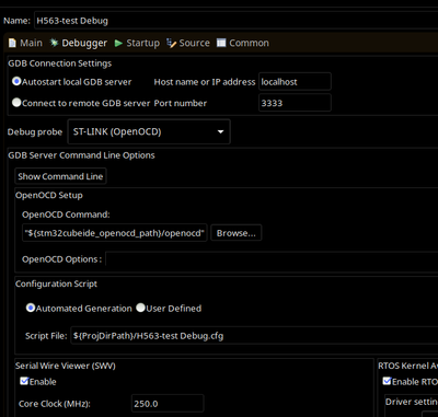

Hmmmm.....if you use openOcd, there is another path -> script file to change:

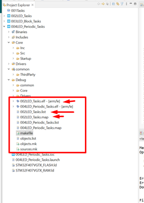

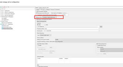

No I didnt use open OCD. I suspect it is about the makefile.
....and i debug setting main :  correct elf file ?
Unfortunately elf file is correct.
I believe, there is something causing these files to be generated under Debug folder. What could it be ? any idea ?
