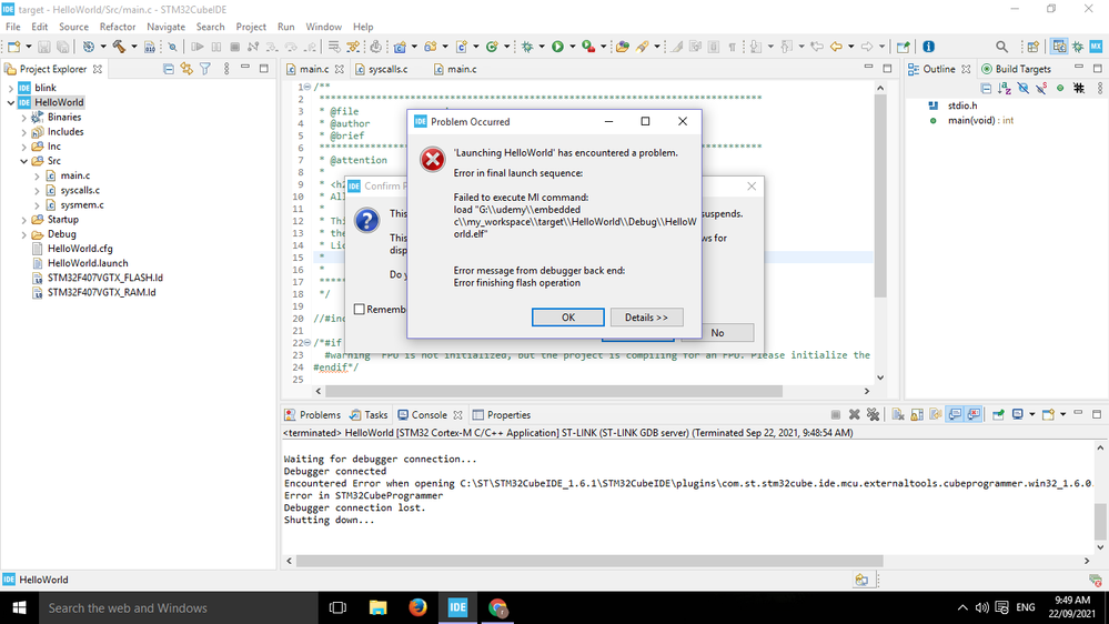

when i am debugging "Hello World" program to target board (Failed to excute mi command:load)
‎2021-10-08 8:44 PM
Failed to execute MI command:
load "G:\\udemy\\embedded c\\my_workspace\\target\\001HelloWorld\\Debug\\001HelloWorld.elf"
Error message from debugger back end:
Error finishing flash operation
Error finishing flash operation ""
2. here is console output "" STMicroelectronics ST-LINK GDB server. Version 5.8.0
Copyright (c) 2020, STMicroelectronics. All rights reserved.
Starting server with the following options:
Persistent Mode : Disabled
Logging Level : 1
Listen Port Number : 61234
Status Refresh Delay : 15s
Verbose Mode : Disabled
SWD Debug : Enabled
Waiting for debugger connection...
Debugger connected
Encountered Error when opening C:\ST\STM32CubeIDE_1.6.1\STM32CubeIDE\plugins\com.st.stm32cube.ide.mcu.externaltools.cubeprogrammer.win32_1.6.0.202101291314\tools\bin\STM32_Programmer_CLI.exe
Error in STM32CubeProgrammer
Debugger connection lost.
Shutting down... ""

STM32CubeIDE is built upon Eclipse and uses gnu tools (linux like) under the hood. All path specs will be transformed between Windows style, Linux style and whatever style else. So, the golden rule is: do not use spaces, umlauts, and other "difficult" characters for the path of your project. Keep it short and use letters and digits only. I spotted a space in "embedded c" in your path. I know, such a rule sounds stupid in 2021, but...

Hmm,
you did in the above screen dumps.
definitely containes a space char " ". If you have changed that, show the new error with its Details.
Here are some common pitfalls/suggestions:
- change the USB cable and/or port
- do not use a USB3 port if possible
- do not use a USB hub, but a direct connection
- Does the board LEDs light up/blink as expected? What board are you using?
- try the STM32CubeProgrammer software. Can it connect to the board and read the flash?
- Are you using a debug probe (which one?) or a board with integrated debug? What board are you using?
- Board with on-board ST-LINK: Do you see the USB drive when you plug-in? The serial port? Like here: https://gitlab.com/stm32mcu/wiki/-/wikis/uploads/b5e0dfb1f8a2eb8ab1f86f63ee08f6f6/devmgmt.png If not: check/reinstall the ST-LINK drivers.
- Anything special like custom board, custom power supply?
- Try re-installing all software from scratch
hth
