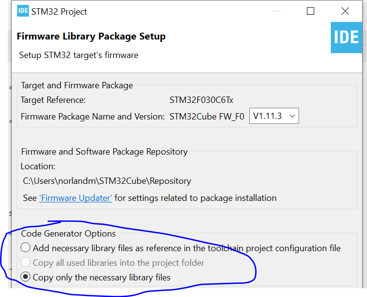

The original project that you are trying to copy. Exactly how was it created?
The answer will depend on that...
More specifically I am curious as to if you kep the default setting here:
0693W00000JOFTCQA5.pngThe default is "Copy only the necessary files". This means the all c/h-files are physically copied from your CubeFW repo into your project. No Eclipse/symlinks.
Assuming you kept this default, then the next question is how you tried to duplicate resources. If you drag and drop resources in the CubeIDE project explorer view, then you can move/copy/symlink (symlink in this case is just an Eclipse metadata link) the resource. On Windows default is move. By holding CTRL, you make a copy. By holding ALT you make an Eclipse link.
If you moved or copied the include path should be simple verify.
If you create a link, then I think that the include path should still point at the original location of the file. Not where it is linked. Not 100% certain.
Maybe this is your issue.
But the entry point to this whole situation is that you want to turn a C project into a C++ project?
If so, right-click on your project > Convert to C++. Careful, you have to walk-through the Assembler and C++ compiler settings to make sure they are OK. We cannot automatically move all settings.

Hi, Mattias!
I did see that, but it was grayed-out in my build. I will go from scratch again and make it work using both your suggestions. (I made a lot of new projects yesterday!) I did discover that the project-specific settings for C/C++ building are more elaborate than the global WS settings pages (hint!).
Thank you for your help! I did not know about the right-click convert option!
