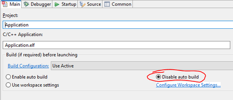

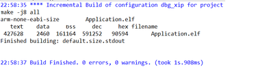

When debug session started
target .elf is checked whether up to date - even though just linked - and only then debug session starts rolling.
How to get rid of this redundancy ?
ferro
Lead
[Run > Debug Configurations > Main > Disable Auto build]
1 REPLY 1
ferro
Lead
