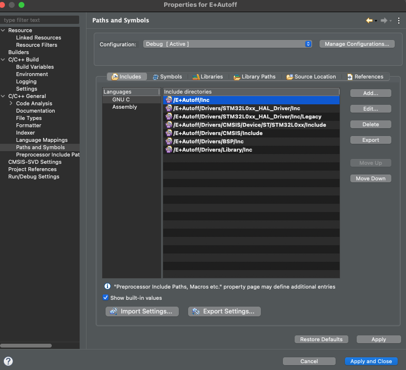

1.using STM32Cube MX Created STM32CubeIDE project
( it can compile and download successful)
2.copy my BSP/ library form Keil MDK folder
3.add library path to
"Properties -> C/C++ General -> Paths and Symbols -> Includes ->GNU C"​

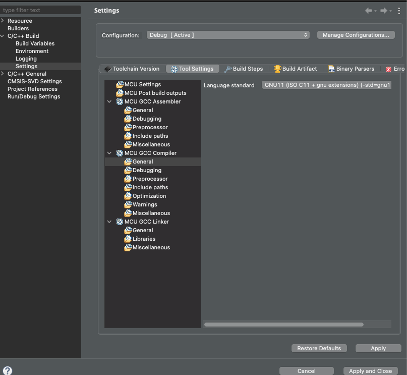

0693W000006FYZTQA4.png​and follow this article i check my project ids using GNU11
​https://community.st.com/s/question/0D50X00009Xka2a/weak-clang
0693W000006FYZYQA4.png​but I got the error message after Building project

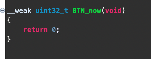

../Drivers/Library/Src/button.c:232:1: error: unknown type name '__weak'
../Drivers/Library/Src/button.c:232:17: error: expected '=', ',', ';', 'asm' or '__attribute__' before 'BTN_now'
make: *** [Drivers/Library/Src/subdir.mk:24: Drivers/Library/Src/button.o] Error 1
make: *** Waiting for unfinished jobs....
can some help me that , thanks

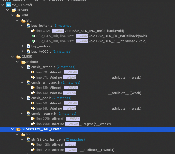

The error message is misleading. __weak is compiler specific, syntax may vary among compilers. You may search in STM32CubeIDE generated code how the syntax should look like and imitate for your code. Maybe showing a little more code could help.

after that i found there have a lot of weak function implement in Hal library
such as
__weak void HAL_ADC_MspDeInit(ADC_HandleTypeDef* hadc)
 /* Prevent unused argument(s) compilation warning */
 UNUSED(hadc);
 /* NOTE : This function should not be modified. When the callback is needed,
 function HAL_ADC_MspDeInit must be implemented in the user file.
so I try include "stm32l0xx_hal.h" to my own library
and that solve the problem
but it make me very confused , In my concept library shouldn't involve to hardware layer
KnarfB
December 14, 2020
There is probably only a macro used which is defined in HAL and related to __weak. Look it up in our code by using the search, goto definiton etc.. functions of the IDE. You may also check the compilers manuals about weak.
weak allows overloading functions at the linker level, roughly comparable to virtual member functions in C++.

Perhaps your compiler demands "__attribute__ ((weak))" ?
Wilson_0706
December 14, 2020
Hi Ozone , KnarfB
Thank a lot for helping
I finally fine the define of weak function in STM32L0xx_HAL_Driver​
 0693W000006FemTQAS.pngand after define  __attribute__((weak)) , this problem was solved

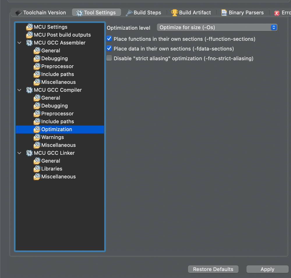

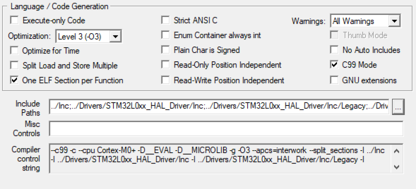

I find another interesting problem about code size,
same project between KEIL and STMcudeIDE have huge different code size
I try solve this problem by this article
If i solve it , I will tell you that ​
​B.R.
In Cube ide
In Keil
