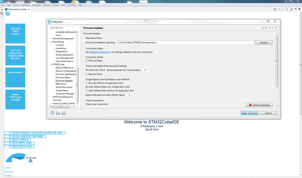

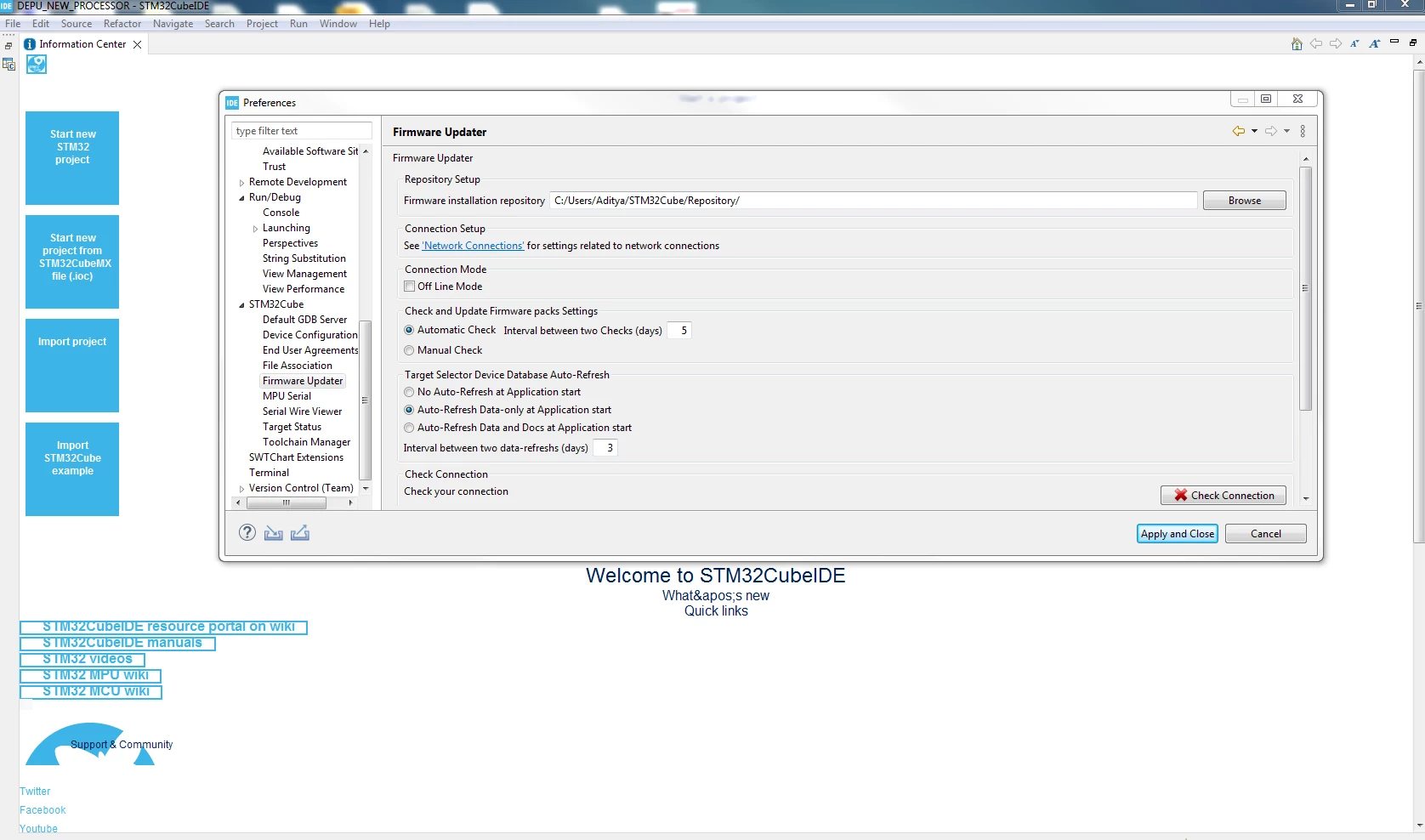

We want to migrate from STM32L4+ to STM32U5 series of processor.. this latest software is not supported by older ide (1.6.0) so we need to migrate from stm32cubeide 1.6.0 to 1.10.0..
I have un-installed the older version and cleared all possible directories, disabled firewall, and removed antivirus. we are using windows7 OS.

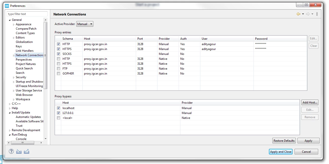

Done appropriate proxy settings in Window-->Preferences-->Network Connections as per https://wiki.st.com/stm32mpu/wiki/How_to_set_up_proxy_and_P2P_Ethernet_connection_with_STM32CubeIDE.
Upon checking connection status in Window-->Preferences-->STM32Cube-->Firmware updater the check connection failure is noticed. I am unable to create any STM32 project as it needs a network connection for downloading the repository.
I am able to connect properly to another computer in our LAB. with the above-given procedures.
Kindly let me know pointers to debug this issue further.

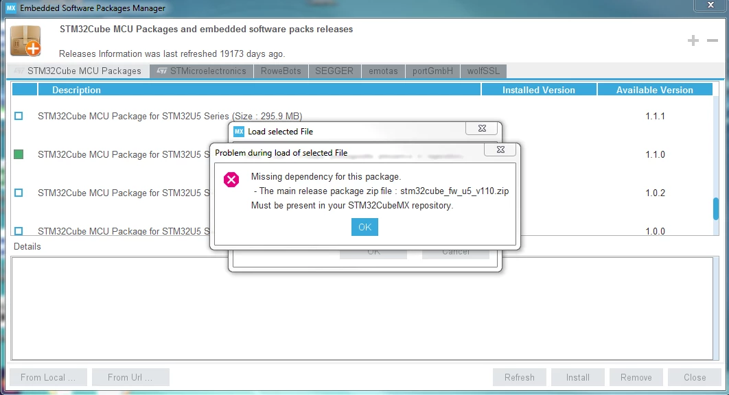

while trying Help -> Manage Embedded Software Packages -> From Local ... i faced the problem mentioned in the attached image. i downloaded the package from https://www.st.com/en/embedded-software/stm32cubeu5.html#get-software
some how I strongly feel the network connection must work for smooth creation of project. Please provide your support to make network connection work on my machine..

Where did you place the FW package?
I believe the Embedded Software Packages Manager is trying to search for the stm32cube_fw_u5_v110.zip file in C:\Users\USER\STM32Cube\Repository

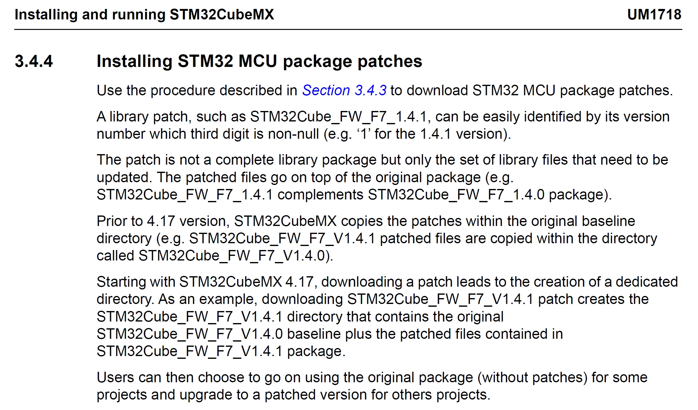

Hi @Markus GIRDLAND​ , @Agour.1​
Can you please follow instruction detailed in the CubeMX UM1718:
Regards,
Aymen.
Aymen CHAKROUN
June 30, 2022
And to be more correct, below the step by step procedure to install the patch:
  1. Download the STM32CubeU5 FW from: https://www.st.com/en/embedded-software/stm32cubeu5.html
  2. Put the zipped file en.stm32cubeu5_v1-1-0.zip under your FW repository
  3. Rename the zipped file from 'en.stm32cubeu5_v1-1-0.zip' to 'stm32cube_fw_u5_v110.zip'
  4. Download now the patch from the same address https://www.st.com/en/embedded-software/stm32cubeu5.html
  5. Put the downloaded patch 'en.patch-cubeu5_V1-1-1.zip' in a place other than your FW repository (e.g: your Download folder)
  6. Try now installing the patch 'en.patch-cubeu5_V1-1-1.zip' using the 'From Local…' button
Let me know your feedback,
Aymen.
Agour.1
Agour.1Author
June 30, 2022
Thanks a ton Aymen.. it worked..

Peter BENSCH
June 30, 2022
Sorry for the trouble with the network settings in Eclipse, which sometimes can be a bit exhausting until you finally get it to work.
Is it possible that you work with your machine via VPN?
In this case, with STM32CubeIDE you are "already in your network", so to speak, and should not need any credentials or proxy settings. Instead of Preferences > General > Network Connections = Manual, please try the mode Direct, which ignores the settings for Host, Port etc. and uses your current Windows settings for network access.
After Apply and Close, please check again with Preferences > STM32Cube > Firmware Updater / Check Connection whether the connection is recognised.
Just a reminder - there are three modes in the network settings whose function is sometimes not obvious or misunderstood:
  • Direct: direct internet connection or already setup outside of Eclipse (proxy settings can be set, but are ignored)
  • Manual: internet connection via proxy settings (host, port, etc)
  • Native: internet connection via thge settings of the operating system, i.e. Windows, Linux or MacOSX (proxy settings can be set, but are ignored)
Does it work now?
Regards
/Peter
Aymen CHAKROUN
June 30, 2022
Hi @Agour.1​ ,
Please follow these instructions to collect more details about your network issue:
  • Backup following two folders [e.g rename .eclipse to old.eclipse]:
C:\Users\<use_name>\.eclipse
C:\Users\<use_name>\.stm32cubemx
  • Open STM32CubeIDE 1.10.0 and set as usual your proxy name and password with 'Manual' setup and only for HTTP and HTTPS
  • Click on Apply and then try doing the check connection (try to do twice the check for eventual conflict in the connection test)
  • If the check connection is failed, please attach us the '.ide.log' file founded under: "C:\Users\<use_name>\STM32CubeIDE\workspace_1.10.0\.metadata"
Regards,
Aymen.

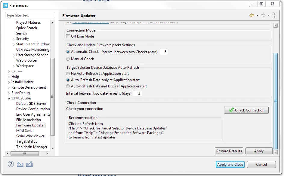

Aymen CHAKROUN
Aymen CHAKROUNBest answer
July 1, 2022
Hi @Agour.1​ ,
I'm suspecting a certificate issue with your proxy company.
The other PC Lab (where CubeIDE execution is OK), is also running on Windows 7 ?
Last trial to test:
  • Open the file "C:\ST\STM32CubeIDE_1.10.0\STM32CubeIDE\stm32cubeide.ini"
  • Remove the line -Djavax.net.ssl.trustStoreType=WINDOWS-ROOT
  • Delete your "C:\Users\<usename>\STM32CubeIDE" workspace
  • Delete .eclipse and .stm32cubemx folders
  • Retry to open CubeIDE, setup your usual manual proxy and perform a test connection (may be do the check twice)
Regards,
Aymen.
Agour.1
Agour.1Author
July 1, 2022
Hi Aymen
Your last trial worked. Thanks a lot, man. Please see the attached snippet. I am attaching ide log for you to diagnose further.
Reply for "The other PC Lab (where CubeIDE execution is OK), is also running on Windows 7 ?" - I have tried two PC with Windows8 and windows7. Please note the fresh installation was done for both of these PCs.
Aymen CHAKROUN
July 1, 2022
Seems your setup is now OK.
