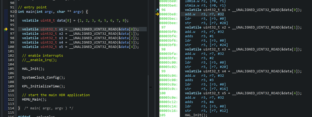

I have trouble with sporadic Hardfaults and I tracked it down to some unaligned access in the USB routines. Although the code uses the macro __UNALIGNED_UINT32_READ, the STM32 will still causes the Hardfault for unaligned addresses. So I looked at the disassembly and found that __UNALIGNED_UINT32_READ is translated into a simple "ldr.w" which, of course, traps on unaligned addresses.
Looks to me like __UNALIGNED_UINT32_READ does not work. I worked around by disabling the Unaligneded trapping, but any idea why __UNALIGNED_UINT32_READ does not work?

I found only one file that uses those macros, and that's "stm32l4xx_ll_usb.c" (for STM32L4xx).
(It's also in "stm32f4xx_ll_usb.c" for STM32F4xx)

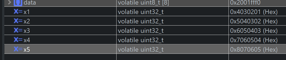

November 11, 2022
FWIW, I can't duplicate this on an F4. __UNALIGNED_UINT32_READ works fine on a STM32F429 with updated gcc.

In stm32l4xx_ll_usb.c __UNALIGNED_UINT32_READ is used only to access the memory that is supposed to be "normal data". For example a buffer in memory.
CM4 can read and write unaligned 16 or 32 bit values in normal memory natively. GCC knows this and generates plain code without any tricks, even with __attribute__((packed, aligned))
Cortex M0 cannot do unaligned accesses natively so the compiler must generate code to work-around.
On the other hand, if __UNALIGNED_*** macros access device or strongly ordered memory on CM4, the compiler should generate workaround, but there's no way to let the compiler know this (?)
Also IIRC M4 and M7 have a SCB bit that can disable unaligned access so that the CPU behaves as CM0. If this is active, gcc is unaware about it as well.
