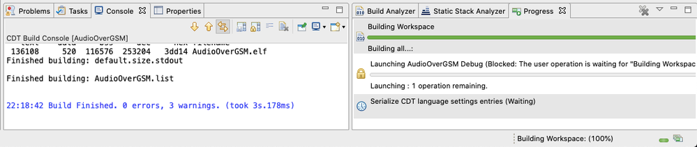

0693W000004GTRTQA4.pngThe build is finished but the bottom right corner still says building workspace 100%.
Here's an image for reference.
When i try to close the IDE, this happens:
Attaching the .log file as well.
