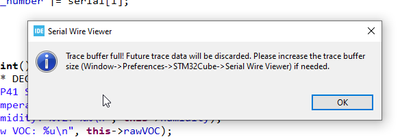

I am using the SWV viewer successfully to output messages from the microcontroller at runtime.
This is a nice tool and usually it works fine.
When I run an application for a longer time (e.g. over night) I get this error
2025-08-11 07_24_40-workspace - TST_SGP41_Drivers_SGP41_API_STM32_SGP41.cpp - STM32CubeIDE.png
I did consider the trace buffer as a buffer like outputting to a UART.
What is happening there?

Trace buffer has a fixed size, but you can adjust it to your needs, as written in the message.
If you have the continuous sampling enabled, especially at small time interval, it will fill the buffer very fast, so don't enable/check this in the swv settings.

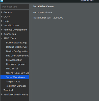

If you only have messages and it fills the buffer too fast, try reducing the message count and size, or/ and set a bigger buffer size, as shown in the message you got.
( In IDE... preferences...)
I set it at 2 MB or so, should be enough.

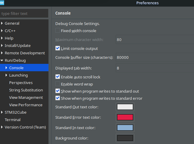

Try ...console settings: - no limit , - bigger buffer
+ increase trace buffer: 2MB -> 20MB
