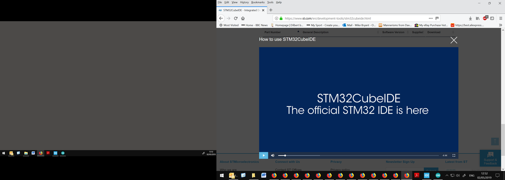

From their video
If it's the ~ OFFICIAL ~ STM32 IDE then I'd expect it to work and work well !!
