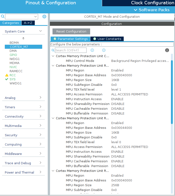

Hello, I am trying to get Ethernet working, I don't like HAL, switched all is possible to LL library. @Piranha Hi, if this is a bug please add to your report if someone try use LL configuring Ethernet.
Platform Linux
CUBEIDE Version: 1.7.0
STM32Cube_FW_H7_V1.9.0
After a lot of odd hard fault I focused again on MPU configuration and I discovered LL CUBEIDE MPU TEX setting got ignored. Is this a bug or am I wrong in some way?
generated code snippet here
/* MPU Configuration */
void MPU_Config(void)
/* Disables the MPU */
LL_MPU_Disable();
/** Initializes and configures the Region and the memory to be protected
LL_MPU_ConfigRegion(LL_MPU_REGION_NUMBER0, 0x0, 0x030040000, LL_MPU_REGION_SIZE_16KB|LL_MPU_REGION_FULL_ACCESS|LL_MPU_INSTRUCTION_ACCESS_ENABLE|LL_MPU_ACCESS_NOT_SHAREABLE|LL_MPU_ACCESS_NOT_CACHEABLE|LL_MPU_ACCESS_NOT_BUFFERABLE);
LL_MPU_EnableRegion(LL_MPU_REGION_NUMBER0);
LL_MPU_ConfigRegion(LL_MPU_REGION_NUMBER1, 0x0, 0x030044000, LL_MPU_REGION_SIZE_16KB|LL_MPU_REGION_FULL_ACCESS|LL_MPU_INSTRUCTION_ACCESS_ENABLE|LL_MPU_ACCESS_NOT_SHAREABLE|LL_MPU_ACCESS_CACHEABLE|LL_MPU_ACCESS_NOT_BUFFERABLE);
LL_MPU_EnableRegion(LL_MPU_REGION_NUMBER1);
LL_MPU_ConfigRegion(LL_MPU_REGION_NUMBER2, 0x0, 0x030040000, LL_MPU_REGION_SIZE_256B|LL_MPU_REGION_FULL_ACCESS|LL_MPU_INSTRUCTION_ACCESS_ENABLE|LL_MPU_ACCESS_NOT_SHAREABLE|LL_MPU_ACCESS_NOT_CACHEABLE|LL_MPU_ACCESS_BUFFERABLE);
LL_MPU_EnableRegion(LL_MPU_REGION_NUMBER2);
/* Enables the MPU */
LL_MPU_Enable(LL_MPU_CTRL_PRIVILEGED_DEFAULT);
Must be IMHO
LL_MPU_Disable();
LL_MPU_ConfigRegion(LL_MPU_REGION_NUMBER0, 0x0, 0x030040000, LL_MPU_TEX_LEVEL1|LL_MPU_REGION_SIZE_16KB|LL_MPU_REGION_FULL_ACCESS|LL_MPU_INSTRUCTION_ACCESS_ENABLE|LL_MPU_ACCESS_NOT_SHAREABLE|LL_MPU_ACCESS_NOT_CACHEABLE|LL_MPU_ACCESS_NOT_BUFFERABLE);
LL_MPU_ConfigRegion(LL_MPU_REGION_NUMBER1, 0x0, 0x030044000, LL_MPU_TEX_LEVEL0|LL_MPU_REGION_SIZE_16KB|LL_MPU_REGION_FULL_ACCESS|LL_MPU_INSTRUCTION_ACCESS_ENABLE|LL_MPU_ACCESS_NOT_SHAREABLE|LL_MPU_ACCESS_CACHEABLE|LL_MPU_ACCESS_NOT_BUFFERABLE);
LL_MPU_ConfigRegion(LL_MPU_REGION_NUMBER2, 0x0, 0x030040000, LL_MPU_TEX_LEVEL0|LL_MPU_REGION_SIZE_256B|LL_MPU_REGION_FULL_ACCESS|LL_MPU_INSTRUCTION_ACCESS_ENABLE|LL_MPU_ACCESS_NOT_SHAREABLE|LL_MPU_ACCESS_NOT_CACHEABLE|LL_MPU_ACCESS_BUFFERABLE);
Thank anyone try address this issue.
