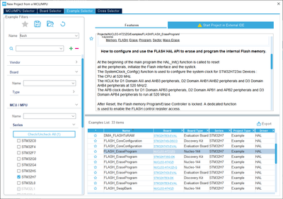

Any idea where I can find a HAL H7 example to write in the Flash?
Use the Example Selector in CubeMX to find and run relevant examples.
Might I suggest looking through the repositories locally with a file browser or manager, or on GitHub directly?
https://github.com/STMicroelectronics/STM32CubeH7/tree/master/Projects/NUCLEO-H723ZG/Examples/FLASH/FLASH_EraseProgram
