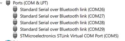

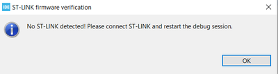

I'm getting an error "No ST-Link detected" with the CubeIDE 1.13.2.
I can detect the programmer in the device manager:
And I can connect and program the board (Nucleo L452RE-P) using the STM32CubeProgrammer.

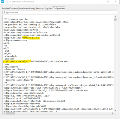

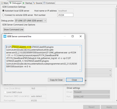

It's a bit weird that the GDB Server in use seems to be from the previous installation, at least looking at the path used in the Debug configuration.
Looking at the Installation details, it seems like there's a mix between the new and the old installation.

For the installations details, it show the path of the installation that has not been changed
since you updated from CubeIDE v1.7 to 1.13.2,

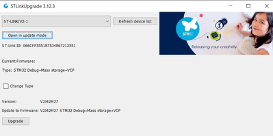

for the STLink can you try to upgrade the STlink from Help>ST-Link Upgrade or verify your cable.

The STLink upgrade works, it detects the St-link which is already at the latest version.

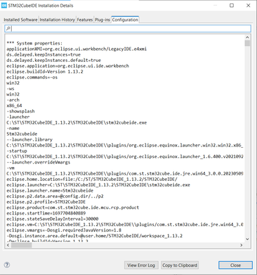

Regarding the mismatch in installation details from my previous reply, that was because I was running the 1.7 IDE (which shows version 1.13.2 and points at all the 1.7 version plugins). Opening version 1.13.2 IDE seems to show the version/paths that I was expecting.
