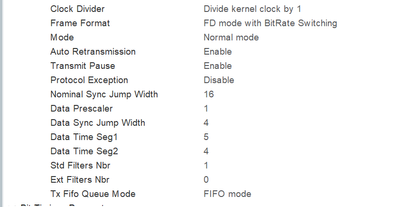

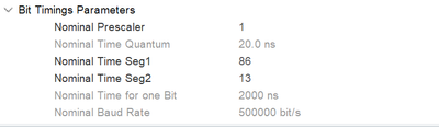

I am Working on FDCAN on STM32H563ZIT6 controller. I am new to FDCAN. I tested the loopback mode that is working fine then I go to the normal mode with FDCAN with two nodes, but the data is not properly reached to node2 RX line. I am using MCP2551 FDCAN transceiver. Is there any references for FDCAN related things for above mentioned controller and please support the FDCAN configuration in CubeMX.   I configured like attached image.
Please let me know is there any mistakes on above configurations. How to select the Message RAM size in CubeMX for STM32H563ZIT6 controller.
