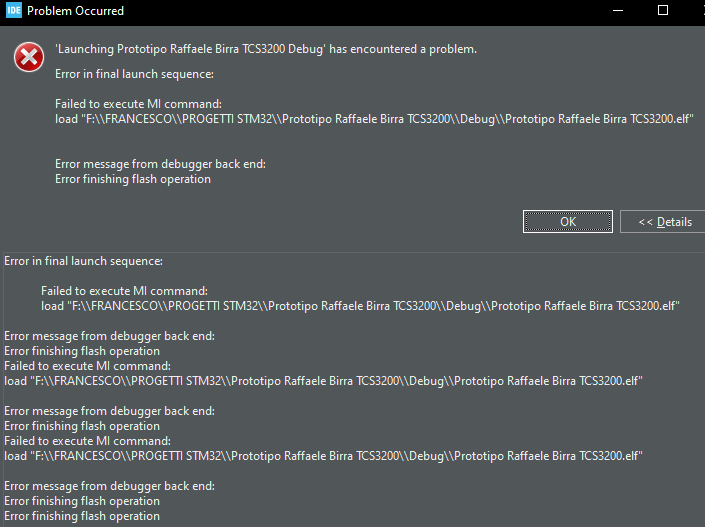

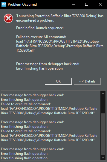

I tried and I can program with a file .bin or .elf, but if I try to program the MCU with STM32CubeIDE it shows me this error below:
So this is a problem if I want to debug or run the program..

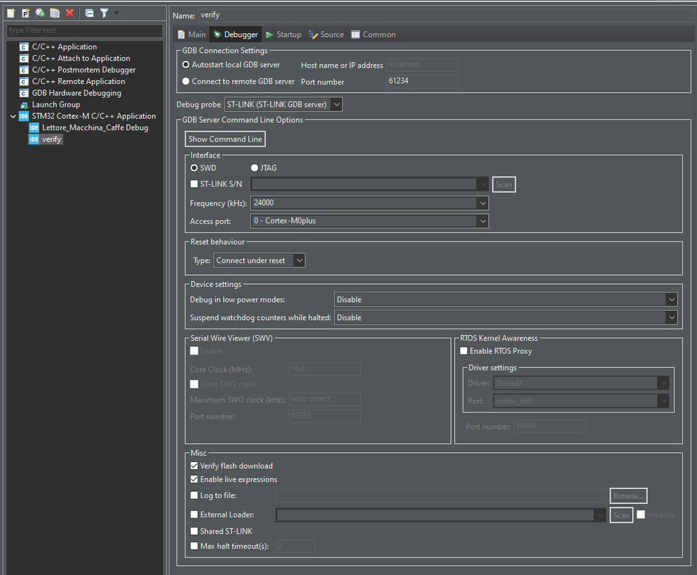

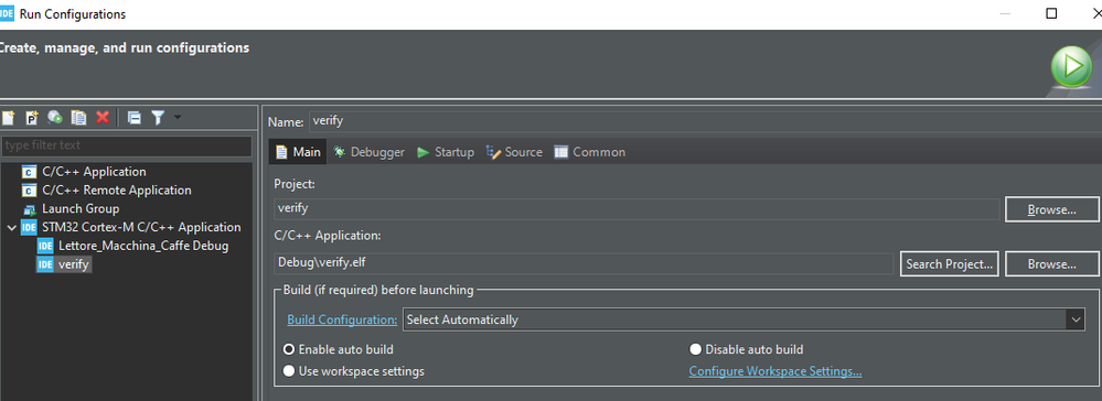

it looks like you are running/debugging it as a C/C++ application...From menu select run/debug configurations, STM32 application and double-click in configurations list to make STM32 run/debug configuration (not C/C++ application, which is for running EXE on your computer).
Check my STM32 Bootloader - flash your STM32 with AES-encrypted binaries right from web browser!
This @Community member​  is everything that I see:
@Georgy Moshkin​ those are my configurations:
This is still from the IDE, and via GDB Server, etc.
Run the "STM32 Cube Programmer" as the stand-alone GUI application, and interact and program the STM32G0 with the .ELF or .HEX directly from that.
This will establish if the device itself is in fact visible, viable and programmable.
You can then check that off the list, and work backward through the maze of connectivity and interactions that are precluding the IDE from doing the exact same task, with the same hardware.
Perhaps the settings for GDB are wrong, perhaps something else already has ownership of the device / ST-LINK, ie a preexisting and live Connection via an STM32 Cube Programmer instance.
With STM32Programmer I can program MCU with .elf file, but I can't program it from STM32Cube.
I disconnect and close every time the STM32Programmer and any other program that is connected to the STM32, so it's not this one.
What could I change in the GDB settings, and also wondering where should I go to see these settings.

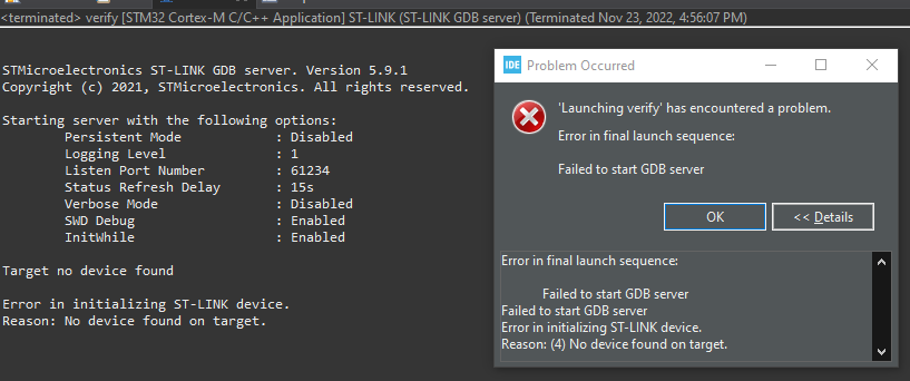

I'm still trying to debug and upload the code via STM32CubeIDE, but I always get the same error and I don't understand what settings I need to change. Do I have to make my own bootloader?
These are the errors I see:
STMicroelectronics ST-LINK GDB server. Version 7.0.0
Copyright (c) 2022, STMicroelectronics. All rights reserved.
Starting server with the following options:
        Persistent Mode            : Disabled
        Logging Level              : 1
        Listen Port Number         : 61234
        Status Refresh Delay       : 15s
        Verbose Mode               : Disabled
        SWD Debug                  : Enabled
        InitWhile                  : Enabled
Waiting for debugger connection...
Debugger connected
Debugger connected
                       STM32CubeProgrammer v2.11.0
Log output file:   C:\Users\offic\AppData\Local\Temp\STM32CubeProgrammer_a08760.log
ST-LINK SN  : 56FF6F067878545228250567
ST-LINK FW  : V2J40S7
Board       : --
Voltage     : 3.23V
Error: No STM32 target found!
Encountered Error when opening C:\ST\STM32CubeIDE_1.10.1\STM32CubeIDE\plugins\com.st.stm32cube.ide.mcu.externaltools.cubeprogrammer.win32_2.0.301.202207041506\tools\bin\STM32_Programmer_CLI.exe
Error in STM32CubeProgrammer
Shutting down...
Exit.
