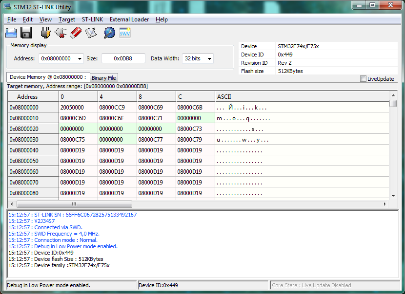

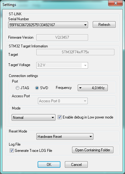

After STM32 ST-LINK Utility, everything works fine with such settings, I can flash the hex file, the firmware works.0690X00000ArwBwQAJ.png

Now changing the settings, the error has changed to:
