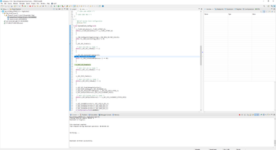

I found a bug in the initialization of the LSI, when low-level drivers are used. The bug is located in the function SystemClock_Config(). Since the background domain access is not enabled before trying to enable the LSI, the loop which is waiting for the LSI to come up is never left.
LL_PWR_EnableBkUpAccess();              // <-- this line is missing in the generated code
LL_RCC_LSI_Enable();
/* Wait till LSI is ready */
while(LL_RCC_LSI_IsReady() != 1)

Actually I tried to reproduce the issue mentioned above using STM32U575,CubeMX 6.9.0 and STM32CubeIDE 1.13.0 and this is what I got please have a look
"LL_PWR_EnableBkUpAccess()"  does exist in the generated code.

Hi Ghofrane,
the code you generated is OK.
Seems that the bug has already been fixed with STMCubeIDE 1.13.0.
(I currently use v1.12.0)
Thanks
