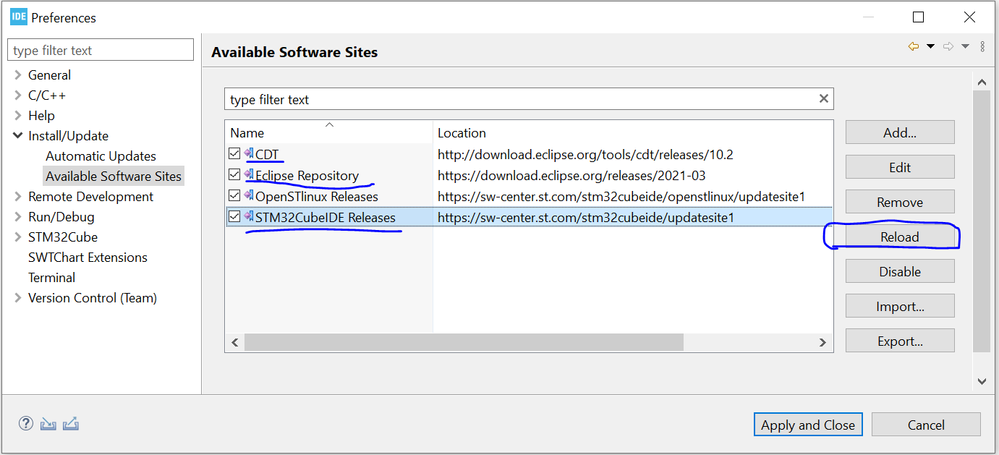

mattias norlander
Could you try in your CubeIDE 1.7.0 installation to do this:
Window > Preferences > Install/Update > Available software sites
Try to Reload, the marked three update sites:
0693W00000KblwVQAR.pngAny error message?
